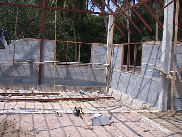

Two windows framed. There is a 'leveled' cement base below the window frame and bricks are being used to level the wall to be even with the top of the frame. (13-Mar-04)

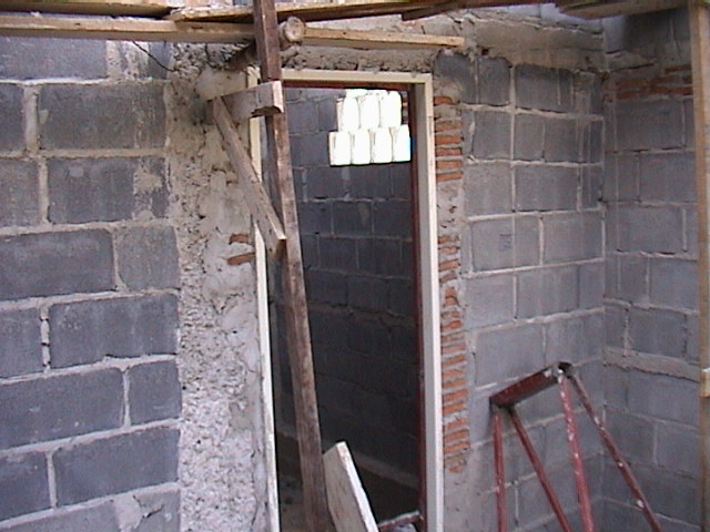

Front door of house framed. There is a cement base above the door frame. (22-Mar-04)

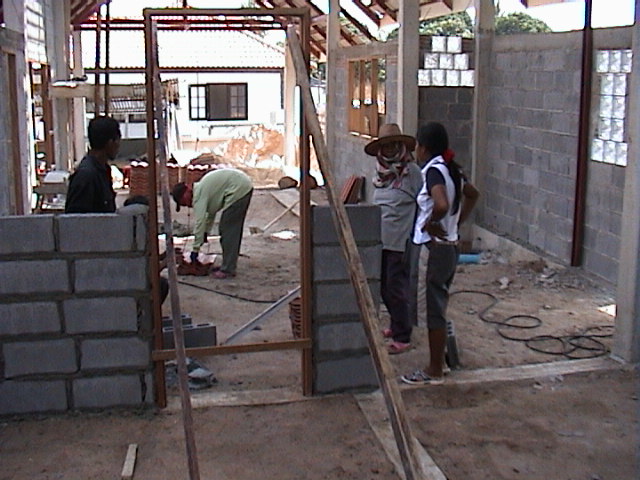

Starting to frame a bedroom door. A piece of 2 * 4 is used to keep the door in place.
These window frames show the how a cement base is placed above and below the window frame, and how the red bricks are used to level out the wall above the window. (28-Mar-04)

Rear door framed and the side design of clear blocks. This side of clear blocks turned out to be poor placement, as when the door is open it blocks the light.

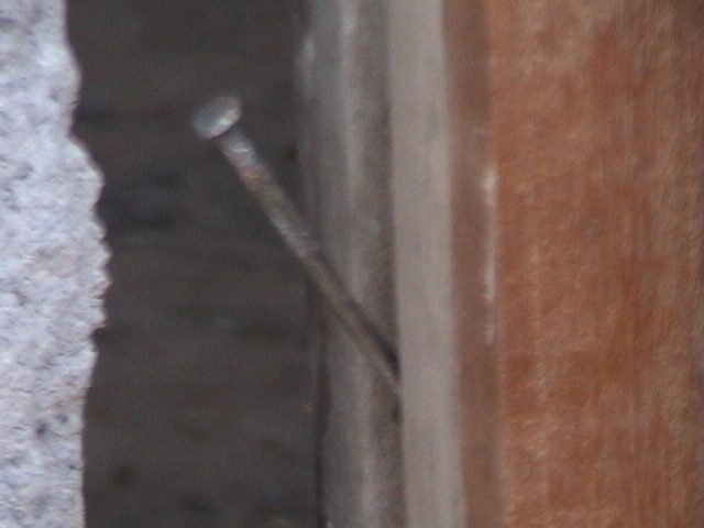

An embedded anchor nail. These nails are put in the door frame at regular intervals (about 15 centimeters apart) and used to anchor the frame to the wall.

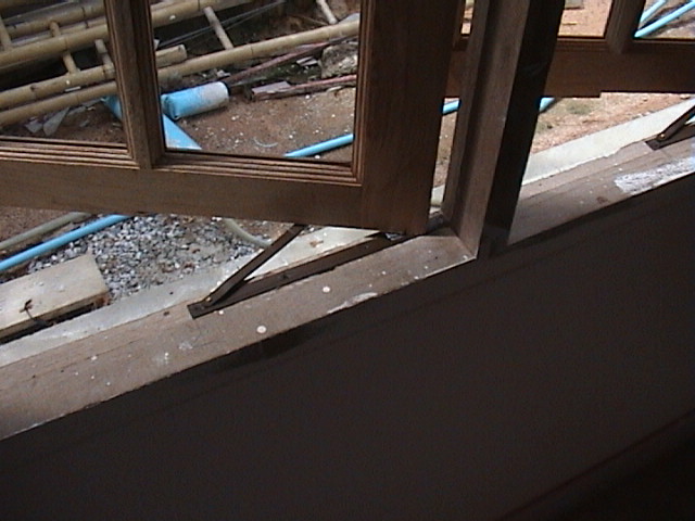

The windows being prepared for the top and bottom hinges. (18-Jun-04)

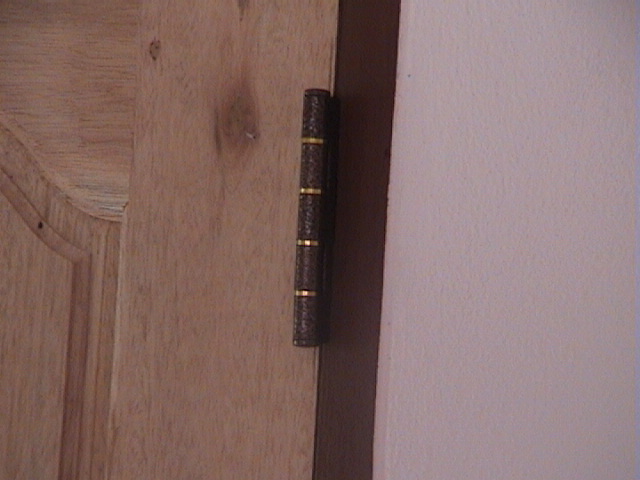

A close up of the top and bottom sliding hinge used throughout. I think these look better than the side mounted hinges. (19-Jun-04)

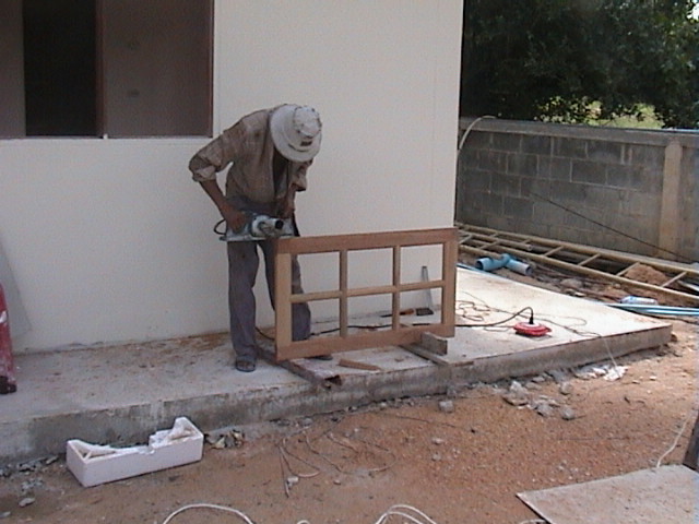

Attaching a window to the frame.

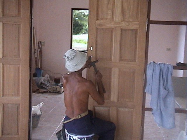

Fitting a door in place. (22-Jun-04)

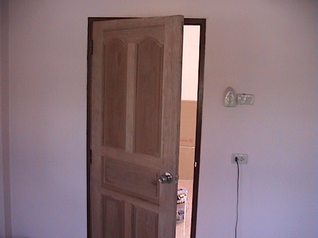

A mounted inside solid wood door prior to being varnished.

Heavy duty hinge on an indoor door. (23-Jun-04)

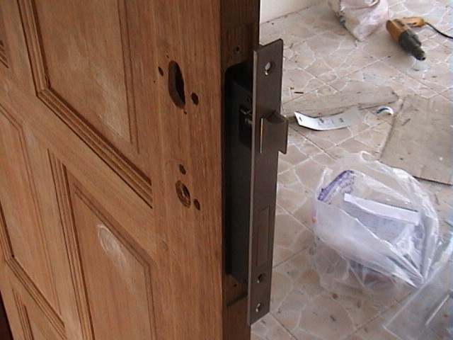

The front door lockset was installed upside down. It is amazing how many different things which go into a house can actually be installed backwards or upside down. (25-Jun-04)
Here is the door lock in the process of being corrected.
This was tough to get installed because it is not the typical 'low quality' lockset and the door installer hadn't done one like this before. Notice the plug used to fix the holes caused during the previous 'wrong way' installation. (26-Jun-04)

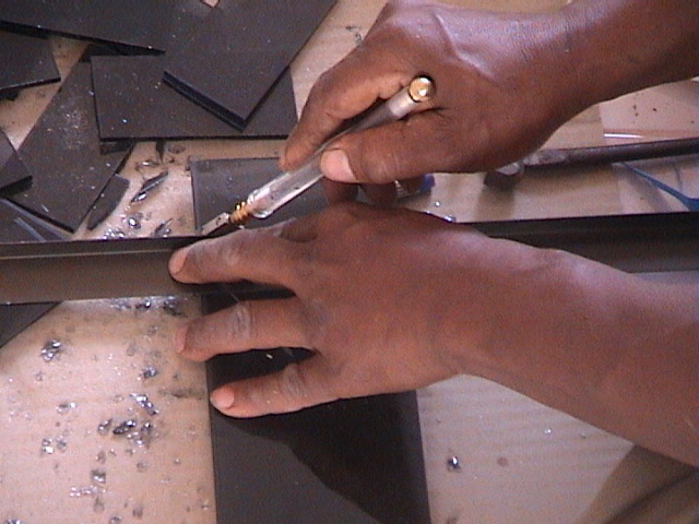

The glass needed to be cut for the grate windows with a glass cutter. (27-Jun-04)

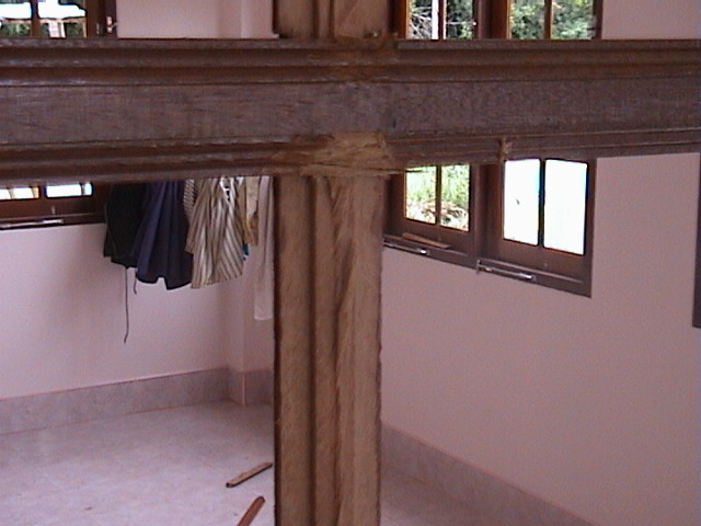

All of the wood windows have an opening mechanism as pictured here. The window can be opened and closed without having to open the screen. The window is opened by pushing the rod, and closed by pulling it. There is also a locking mechanism on the top of the windows (not shown) which allows the windows to be locked without opening the screen.
The wood windows after a couple of coats of varnish. (27-Jun-04)

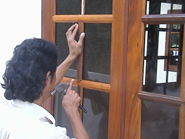

The glass installer re-attaching the front retaining wood after the tinted window glass has been installed.
The final step is to caulk around each window piece installed.

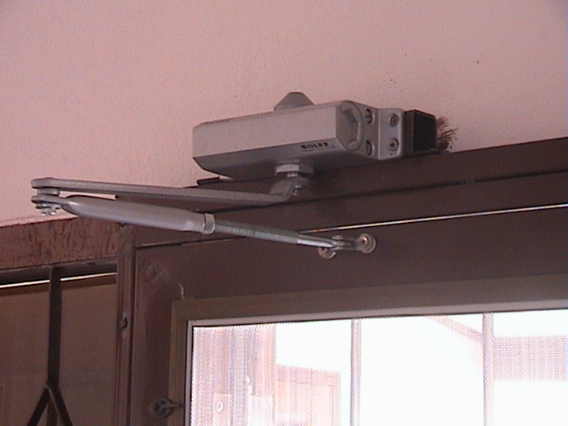

The automatic door closer on the front screen door was installed upside down, and this by a person who says he has installed hundreds all the same way. Notice how he had to use a special metal block to secure the opener, above the door. (14-Jul-04)
Here he is fixing the installation. The opener goes on the door itself, the arm attaches to the frame.
