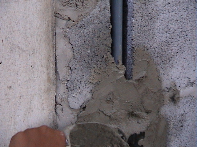

PVC conduit is run up the wall to house the electrical. (22-Mar-04)

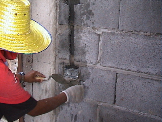

A small outlet box being set in place. (02-Apr-04)
The PVC is then cemented in place.

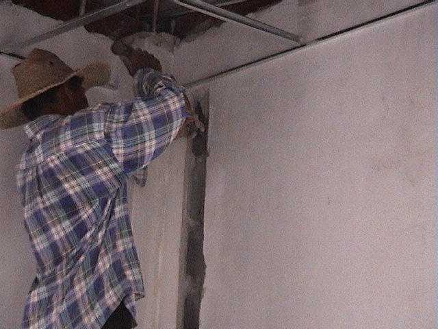

Opening being made for the circuit breaker. (12-May-04)

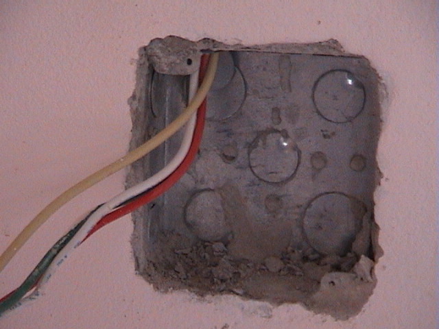

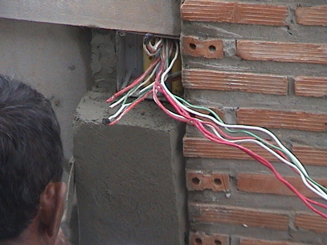

There is always a trio of wire, red is positive, white is negative and green is the ground.

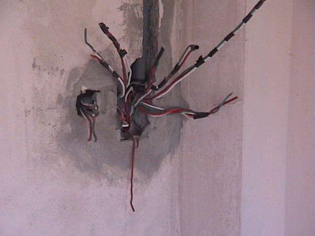

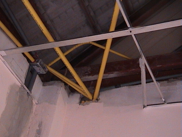

The entry switch box with 6 groups of wires. On the left is the electrical for a fan. (23-May-04)
Another shot of electrical PVC conduit. The switchbox mounted above the wall on the left really isn't necessary. It was installed by the first electrician.

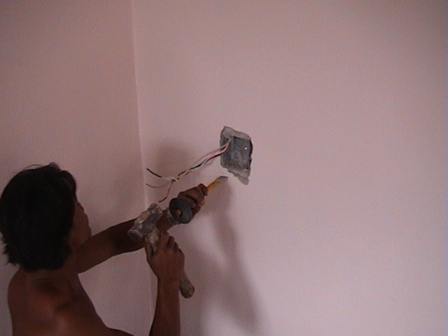

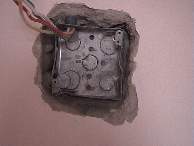

Sadly the first electrical guy didn't really do too good a job. For example, here we discover the large socket outlet boxes are set in the wrong orientation. (26-May-04)
So they need to get chipped out.
And reset again. Notice now how the tabs are on the left and right side.

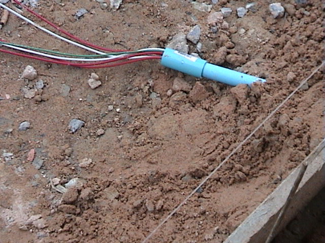

Under the patio runs this PVC which feeds the lighting on the wall and then runs to the pumps. (03-Jun-04)

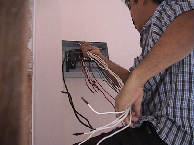

Preparing the circuit breaker. (19-Jun-04)
The inside of the mounted circuit breaker. This is still in progress, the ground wires (grounding electrode conductors) are still to be added.

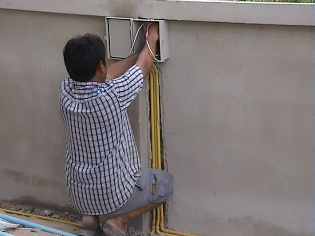

Setting up a switch box for the two water pumps on the outside wall. (29-Jun-04)

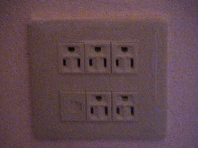

This shows a large socket box with 5 small plugs and a telephone connection. The only problem with these small socket receptacles being so close together is you cannot really use two adjacent plugs, because typically plugs will be a bit too wide.

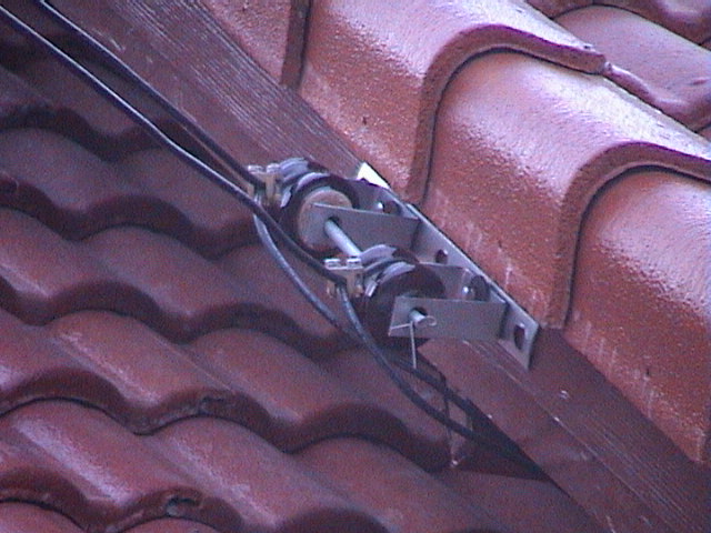

The electric is feed in from the street to the roof and attaches here.
