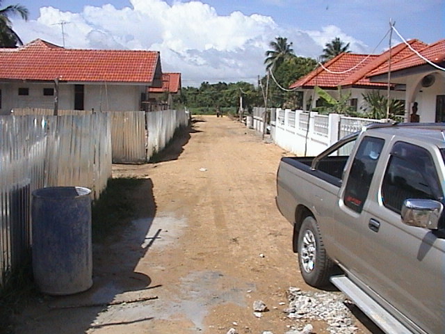

To the left of my truck is the building plot. My truck is on the dirt entry road. Looks good enough here doesn't it. (01-Jan-04)

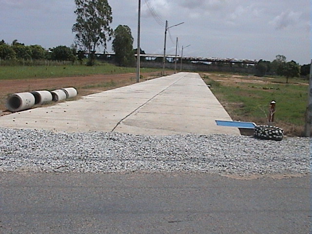

I wanted to contrast the previous road to what everyone would really like to see. This land is subdivided and a concrete entry road has been poured to a 20 centimeter depth. There is also associated drainage and the electric is already setup, all prior to any building started. Now, the downside. This land, which is in the same area as the cool thai house plot, is 2 1/2 times more expensive, and the minimum lot size is 1 rai (at 2.5 million Baht)! So, you can find perfection but you must pay the price! (29-Jul-04)

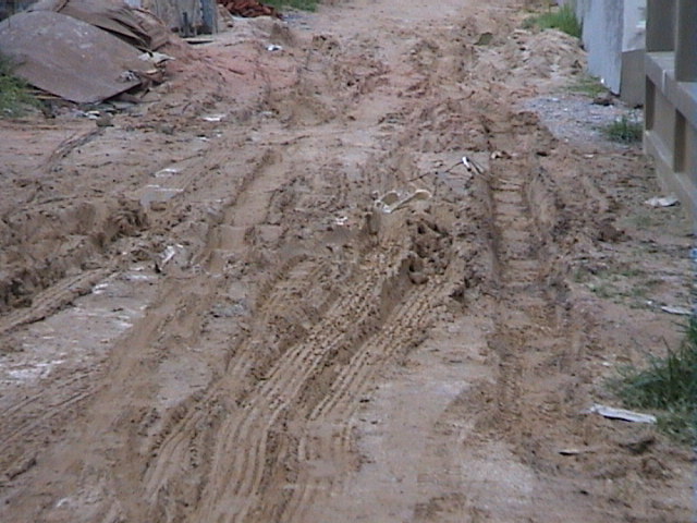

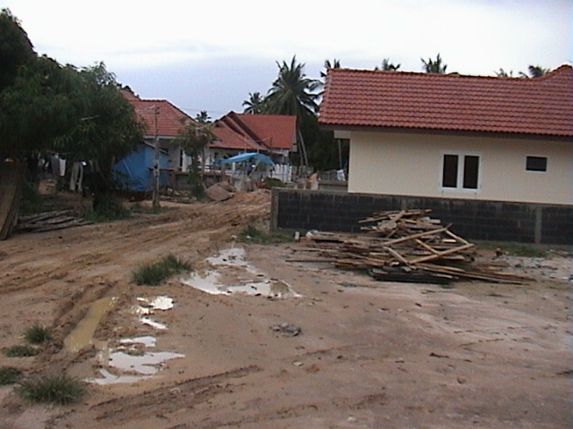

The entry road has been getting bad for quite some time now until it is like this! Passing is now impossible except with a 4 wheel drive. (22-May-04)
Another shot of the entry road. It was made with the wrong kind of dirt and is now a muddy mess. The cool thai house is the last one on the left.
Here I'm just wondering how much worse can the road actually get before someone does something. (31-May-04)

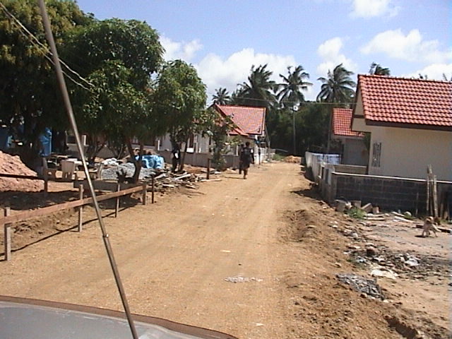

Finally, the road is what I would call fixed! One cardinal lesson for all who build houses is never skimp on fill dirt, one thing which can't be fixed is a house below street level. Note the level of the house on the left is about 60 cm. or more below street level. (12-Jun-04)
A current shot of the fixed road with the cool thai house at the end on the left. The dirt used is a dirt and small stone mix which is used mainly for roads. It gets real hard and will not turn to mud when water sits on it. One last thing which needs to eventually done with the road is to shape it as rounded, which can't be done as long as the aluminum fence is run along the far right side of the road. (18-Jun-04)

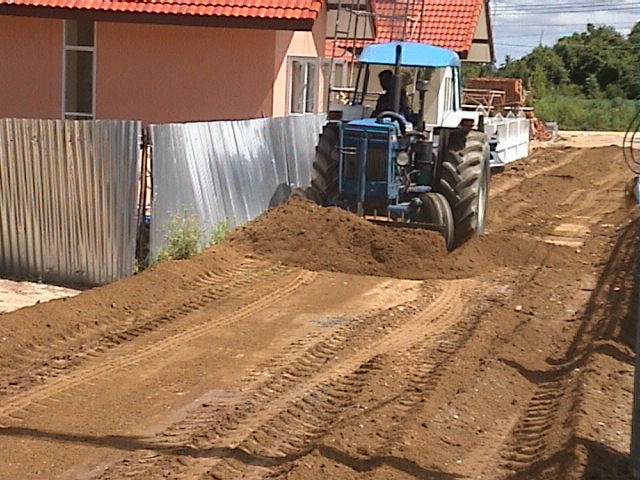

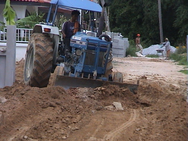

The 'too low house man' hired a tractor today to bring the road down. In sorting out his problem he may well be on the way to creating problems for all of the other inhabitants. (01-Jan-04)

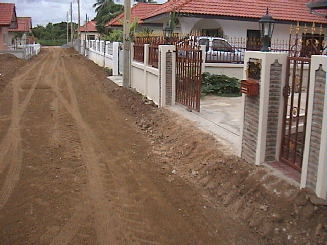

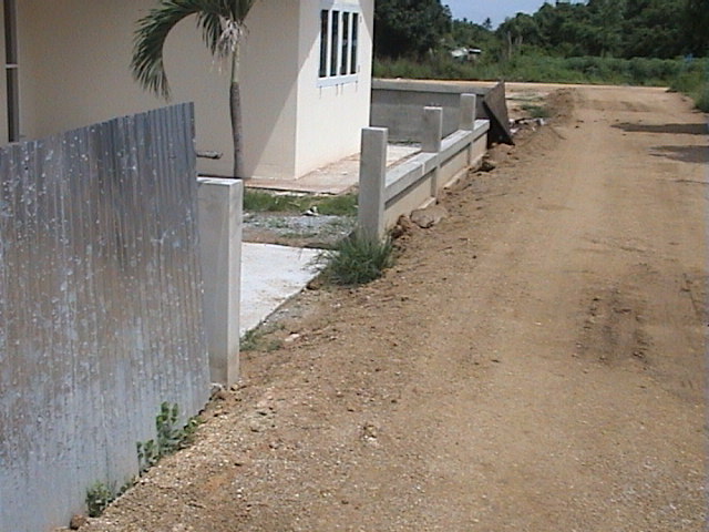

All the finished houses on the right side of the road now have a problem. No only was the road taken down after the houses were built, but slope of the road does not now allow the water to run. (06-26-04)

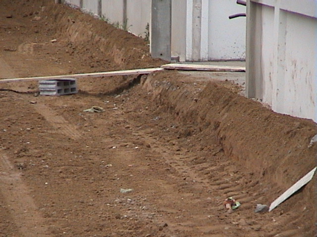

The front of the second house from the front after the road massacre.

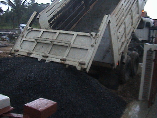

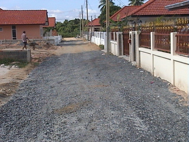

As a temporary fix, I'm having road stone put down. (20-Aug-04)

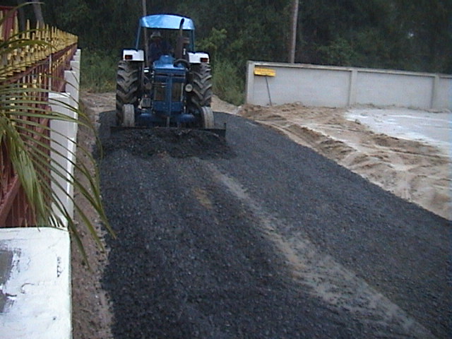

Here is the tractor laying out the stone. This is great material, even when wet it maintains its shape.

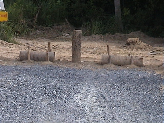

Had the end of the road blocked off with old coconut stumps. (24-Aug-04)

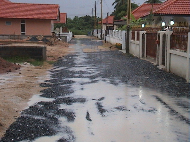

Here is the road on a rainy day. Even though the water puddles a bit it is no problem on the areas covered with road stone, since these stones act almost as good as a paved road. The puddles don't get much bigger than this and then the water runs off. (02-Sep-04)

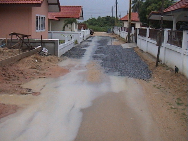

Here is a puddle further up the road.
Some areas along the road flood out easier than others. Here is the same house as before with the same problem.

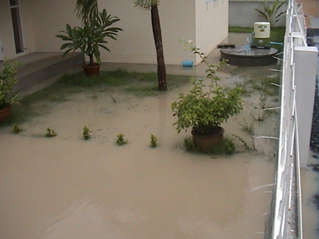

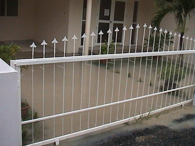

Inside view of the yard of the 'too low' house, after rain.
