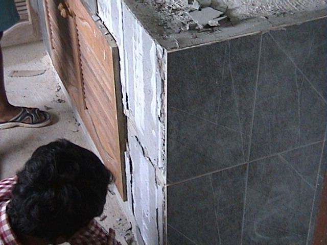

A bit of repair in process. The tile on the front of the cabinet was not even with the door, so the tiles are being removed. More cement will be added to adjust the level. (21-May-04)

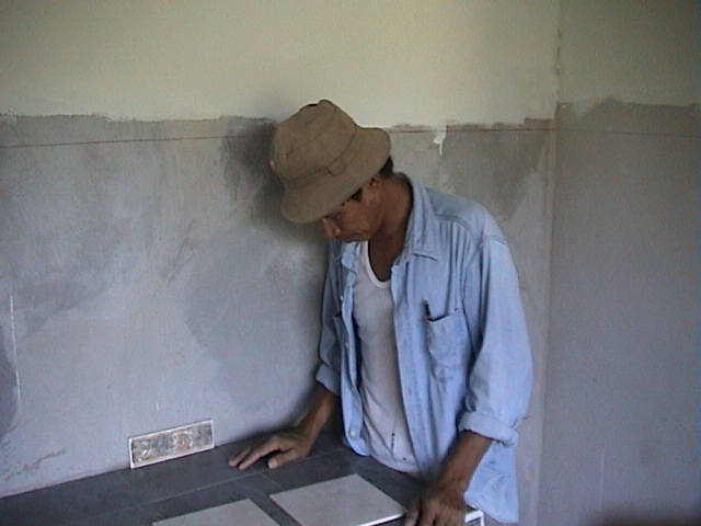

The kitchen tile expert selecting tiles. (24-May-04)
