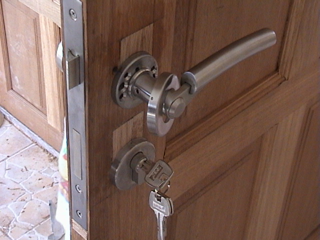

This door lock caused a lot of problems. I would, in the future, go for a more easy to install model. (26-Jun-04)

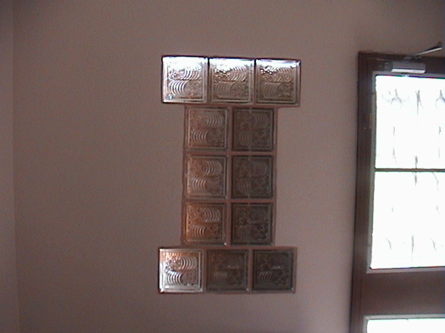

These glass bricks were poorly placed. This goes along with the point about spending more time in the planning phase. When the door is opened, the glass bricks are covered (which defeats their purpose of allowing natural light to filter in. (23-Aug-04)

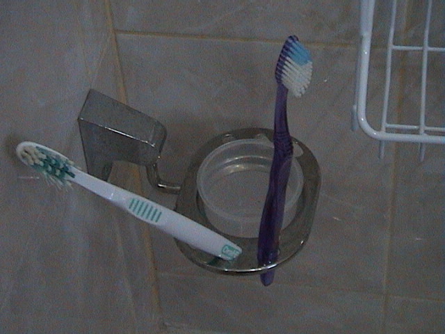

Here is something you wouldn't (or at least I wouldn't) think of. A toothbrush holder where the holes are too small to hold a toothbrush. (26-Aug-04)

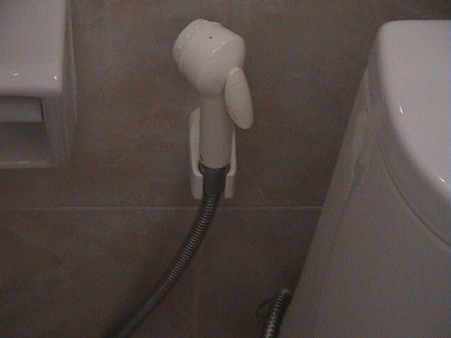

This is another case where most expensive is not necessarily best. These Grohe bottom washers are super heavy duty but somehow constrict the water flow, meaning that the emitted water is low pressure. A low cost standard washer has not problem with pressure. I know it is these washer since I had two installed and they both had the same problem. Later I replace on with a 'cheapy' and that one works great. There's got to be more of these, but I can't think of any others now.....

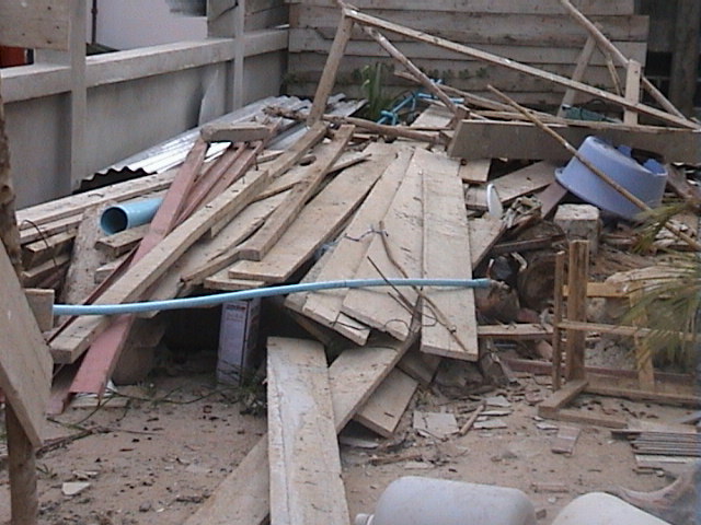

OK, I just thought of another small one. Grounds control, by which I mean monitoring all of the liter, building supply fragments, etc. which end up filling the ground surrounding the house. Some is unavoidable, but in this project I waited until the end to get on this and there was just too much small fragments of tile, roofing material, etc. all around.
