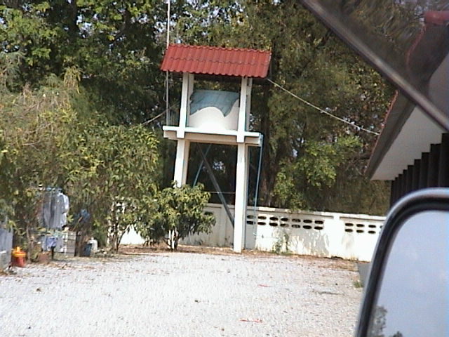

water tower
This is an example of a communal well. Everyone in the immediate area is serviced by this well and water tower. As of the time of this picture, there was basically no water service 23 hours a day each and every day. Most everyone was trying to sell their house or townhouse in the area, makes you wonder if it is possible to sell a house with no water? (19-Apr-04)

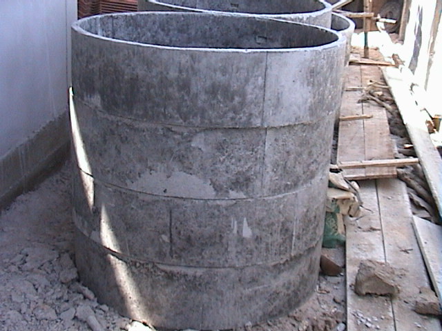

drainage ring
like the one shown at the left. The drainage assembly comes in 3 basic diameters, 1 meter, 1.2 meter and 1.5 meters. Each piece has a depth of about 30 cm., so there are about 3 per meter. The smaller diameter is normally sufficient for a single house. (19-Apr-04)

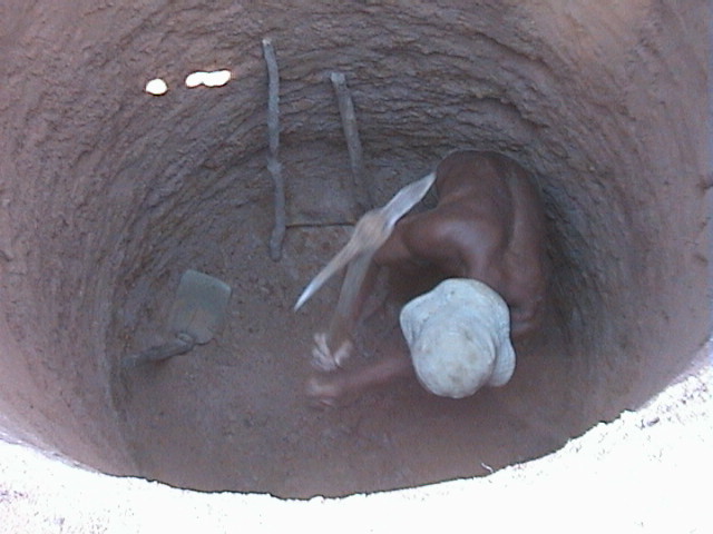

The well digger starts by recommending a point on the land which have good prospects for having low depth water levels. Then he digs a hole freehand in the ground slightly larger than the diameter of the concrete well fitting. The hole is dug straight down until water is reached. At this point some concrete well fittings will be inserted to add some weight and structure to the well. The mud will continue to be dug out until a pump is needed. The well is continued to a agreed upon point where the depth is sufficient to supply water all year around, normally a couple of meters deeper than when water is first encountered.
The season for well digging is relatively short. The best time to dig a well is in the dry season when the water table is at its lowest point. Well digging is a specialty due to the high danger involved. Regular day workers cannot do it. The well diggers that are good are pretty much booked up with continual work during the dry season. A day labor rate is not common. A rate including materials (ie. concrete rings) could be arranged, but it is not the common way of doing it and would be more expensive anyway.
hand dug well
The hand dug well is a pretty amazing feat. A hole is dug to a slightly larger diameter than the circular drainage fitting to be used. The hole will be no more than about couple of centimeters wider than the rings. (24-May-04)

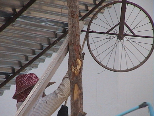

dirt pulley
A wheel is used to help bring the dirt to the surface. (19-Jul-04)

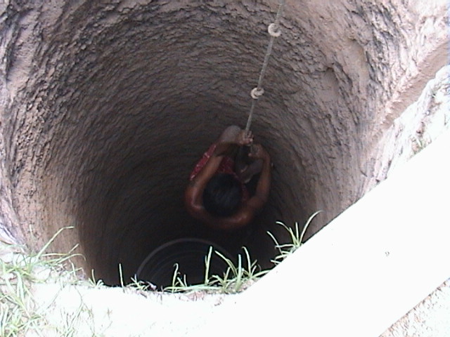

descend with rope
Once the wells starts getting deep the digger will descent using a rope. (09-Apr-04)

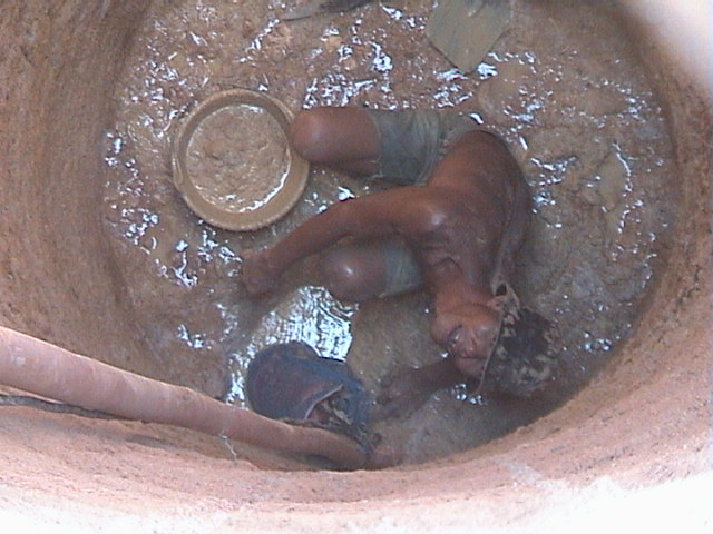

pumping
When water is reached a pump is utilized so that digging can continue down another 1 or 2 meters until the water is sufficient to use all year around. (29-May-04)4)

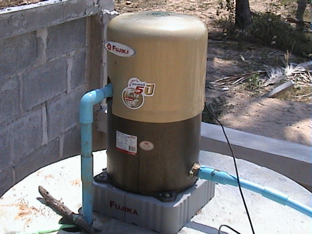

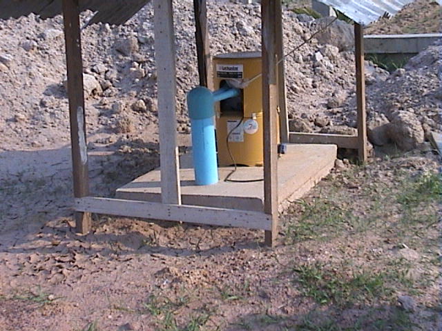

automatic pump
An automatic pump of the type used for hand dug wells, this is a Fujika GF-225 automatic home pump. Good quality pumps run 5000 Baht or more. (19-Apr-04)

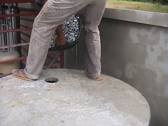

One common problem with surface wells is dirty water. Once the rings are inserted there is a gap between the rings and the side of the hole. Once the rings are placed all the way to the surface, this gap needs to be filled with small stones. In the well for the cool thai house prototype, this was not done. The well digger said he had done it, but in fact he had placed broken up blocks on the side of the well. This causes a 'pocket' to develop outside the well that fills with water and creates pressure on the outside of the well structure. This in turn can cause fractures in the well rings and then the water can flow in from the outside. When it flows in, instead of seeping in, it brings in a lot of dirt and sediment. The end result will be water so muddy that even a filtration system will not make it clear. Be sure to check when your well digger is finishing off the well, as this is a critical step.
seepage stones
The side of the well needs to be filled in with small stones, to prevent air and water pockets forming outside the well. (12-Jul-04)

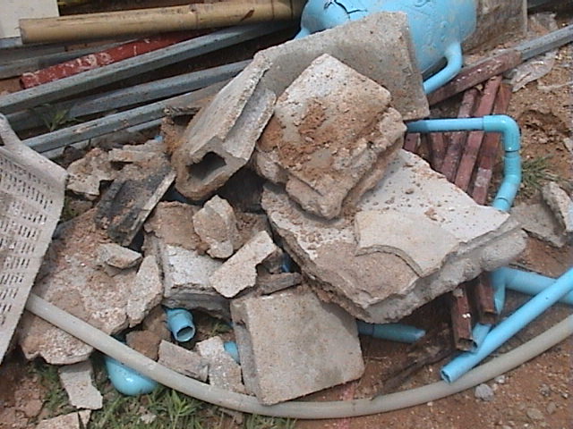

broken block instead of stone
Quite amazingly, originally, the well digger had put in big chunks of broken up blocks instead of rocks, thus saving about 20 minutes of labor time. Later we dug these blocks out from the side of the well.

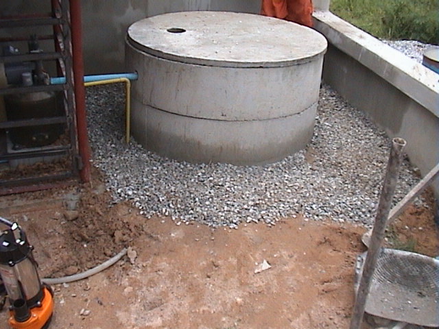

stones
Stones like this need to be placed around the well.
well now prepped
Here the well is now prepared for a cement base.

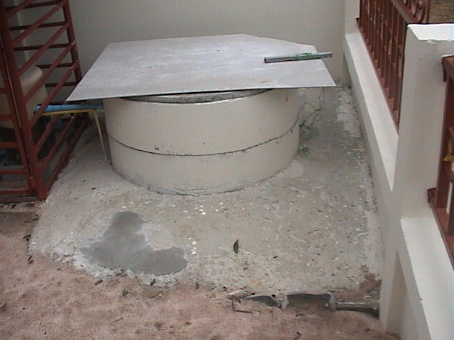

corrected well
Here is the corrected well finished off with a cement base. (19-Aug-04)

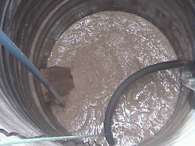

water not clear
If you have a problem like this, the water in the storage tank will not be clear, even if it is filtered. Here is a shot of cloudy water in the tank before fixing the well. (06-Jul-04)

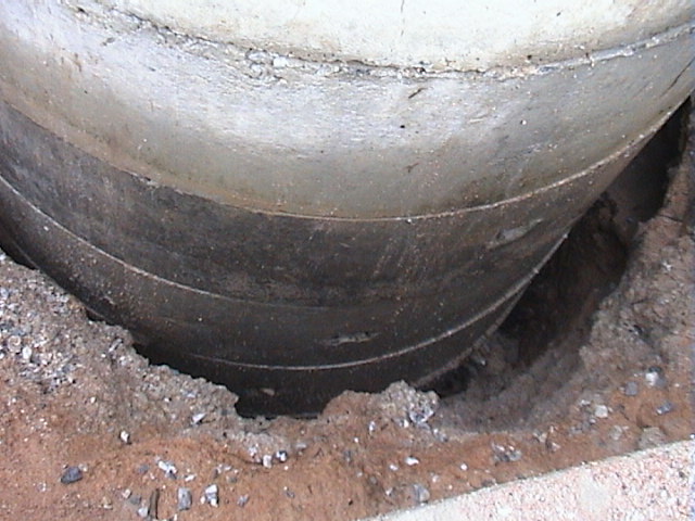

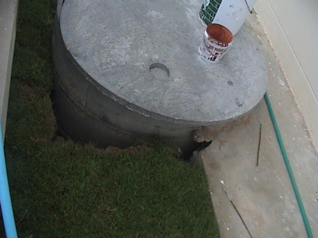

well must be at least one meter from house
One other thing to note. A well should not be dug within a meter of the house. This shot shows a well within about 40 centimeters from a house and also you can see the gaping holes around the well due to settling. The settling around the well can further cause a lot of problems for the house structure, for example wall and flooring cracks. (28-Jul-04)

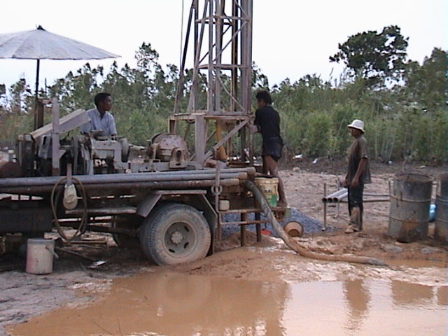

rig drilling deep water well
A rig at work drilling a deep water well. (03-Apr-04)

There are many configurations of equipment you can use to retrieve, store and deliver the well water to your house. At a minimum you will need a pump suitable for the type and depth of well you have. An automatic pump for a hand dug well will cost about 5000 + Baht, for a good one.
In my opinion a water tank is also a good idea. First off, it allows the water to be pumped up and stored for periods of heavy water usage (like when the grandkids come to visit!). Secondly it give sediment in the water a chance to settle out. You can either get a pre-fabricated stainless steel tank or have a tank constructed from you. The hand constructed tanks are formed either from concrete well fittings or can be built from cement blocks. The pre-fabricated tanks can be purchased in many sizes, with a 1500 liter size costing about 8000 Baht to 10,000 Baht (depending on the brand and quality of the tank).
If your water tank is mounted in a high enough configuration the pressure will be sufficient to drive the water into your house. If however the water pressure is not sufficient you may need to add an additional automatic pump. Often the water tank is mounted in a tower, which will give the necessary height to ensure sufficient water pressure in the house. One of the real nice advantages of a tower is this: even if the power goes out (and the pump is not operable) you will still have water.

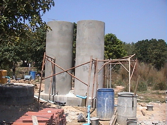

homemade water tanks
This is a pair of homemade water tanks. These are made from circular drainage fittings and cement. (17-Apr-04)

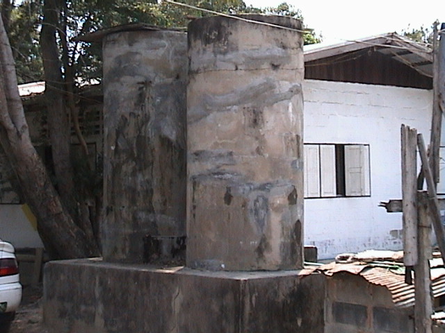

water tanks two years old
Here is a similar version about 2 years old. They tend to age rather quickly due to water seepage and generally look kind of ugly. (21-Apr-04)

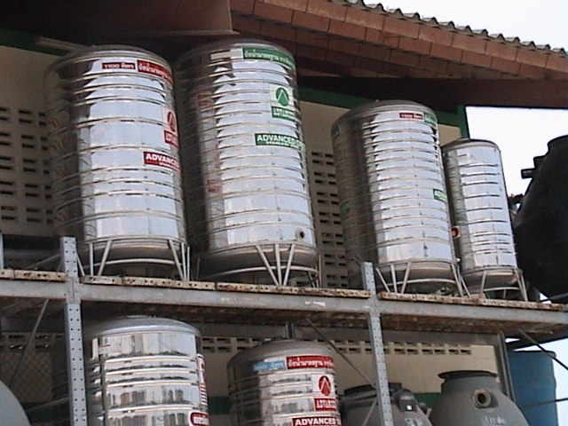

stainless steel tanks
I like stainless steel tanks which come in various sizes and shapes. For a single family house I would recommend storage size of 1000 or more liters. The cheaper plastic type (which you can see in the lower right of this picture) are not recommended. They supposedly are harder to clean and have problems with algae growth. I recently priced an 1600 liter stainless steel tank for 8500 Baht including delivery. (21-Apr-04)

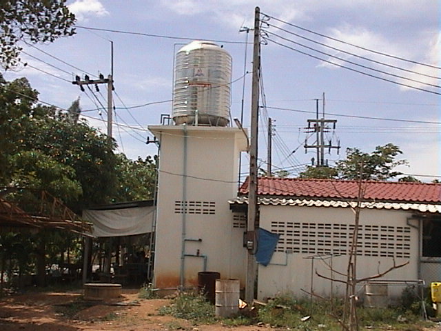

large tower
This is a large tower which services several small apartments and is more than what would be needed for a residential house, but it gives you an idea. The base of this one is 2.70 meters square. The height is about 5 meters and water capacity of about 2000 liters. (27-Apr-04)

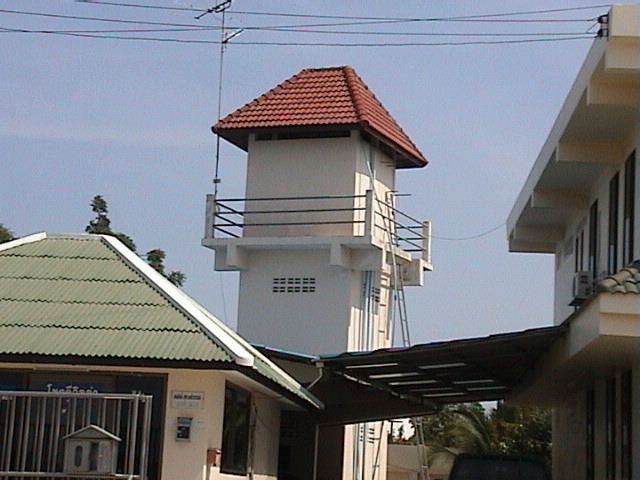

water tower on bathroom
Here is another idea for a water tower This one is built on a bathroom, but you could also do a storage room underneath. The tower sets on top at a height of about 5 meters. The tank has about a 2000 liter capacity. (11-May-04)

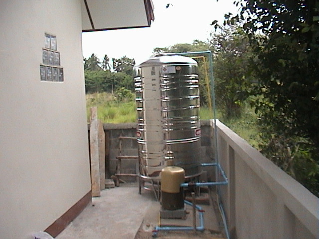

water tank with no tower
Here is a water tank with no tower, which is how I did it in the cool thai house. The downside to not having a tower is that an extra pump is needed to drive water into the house. (02-Jul-04)

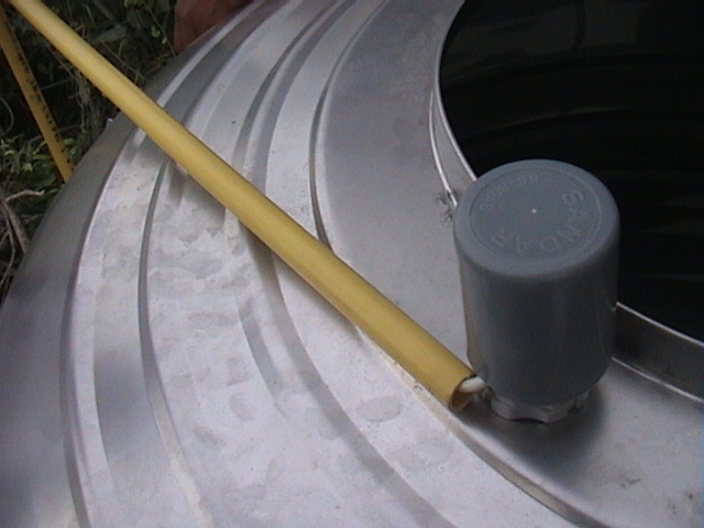

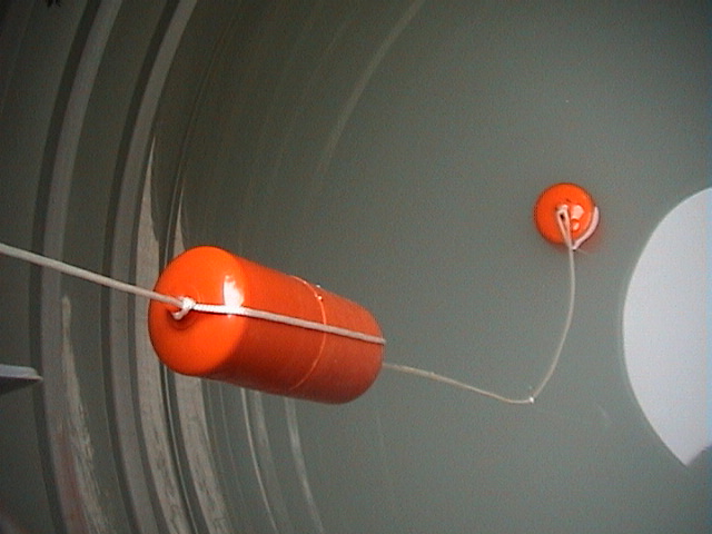

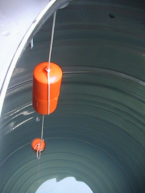

water valve
I had to look around a while to find the electric valve as shown below. Using this valve I can define the fill point in the tank. In the cool thai house example, the tank drops to 50% before the pump is activated. This has two benefits... it is more efficient use of the pump and it allows the water to sit and any impurities to filter down before being pumped to the house.
electric water valve
The electric water valve is controlled by 2 floats which control the 'shut' and 'open' valve positions. (19-Aug-04)
valve mounted on top
The valve is mounted on top of the water tank. The electric is shielded in yellow conduit. (06-Jul-04)

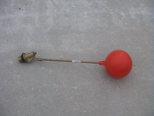

conventional floater valve
A conventional floater water valve. Using this type of valve (much like a toilet valve), the pump will open almost after each use. (19-Aug-04)

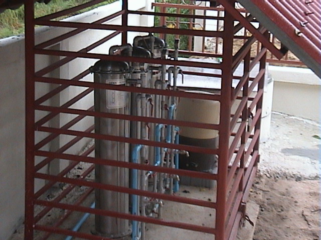

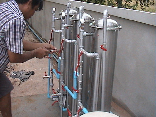

filtration
Filtration systems allow the raw well water to be filtered before use. Although not absolutely necessary, they do improve the cleanliness of the water. The cost is around 20,000 Baht for a system such as the one shown below. This system has three filtration units, each using a different mineral for filtration. The minerals used are carbon, magnesium and an ionizer. One thing I don't like about these particular filter tanks is that it is not easy to change the cleaning agent, which needs to be done yearly. To change it the top or bottom of the unit needs to be unscrewed and then the tank can be moved off its base and the material flushed out. Since I purchased this set at Homepro, I've seen other models where the cleaning agent can be flushed out of a valve.
filtration system
This filtration system has three units which are made of stainless steel. Each unit runs the raw water through a different filtration agent; carbon, magnesium and an ionizer. (09-Jul-04)
lockable metal enclosure
The units in this example are housed on a cement slab and enclosed in am lockable metal enclosure. (19-Aug-04)

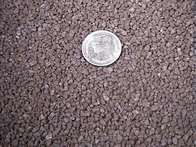

raw magnesium
A close up of some of the raw magnesium used as a filtration unit. The tanks are basically filled with granules and the water is forced through the granules. (19-Aug-04)
