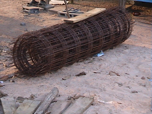

Metal is used to add strength to the floor. The metal that comes in rolls is cheaper but is not very good and should be avoided if possible.

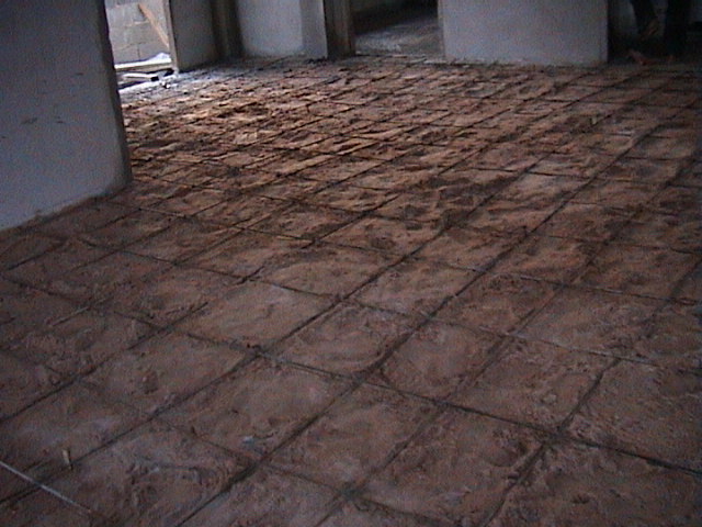

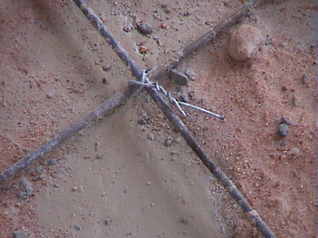

To prepare for the pour 2 hun metal is hand tied into a mesh pattern. (20-Apr-04)

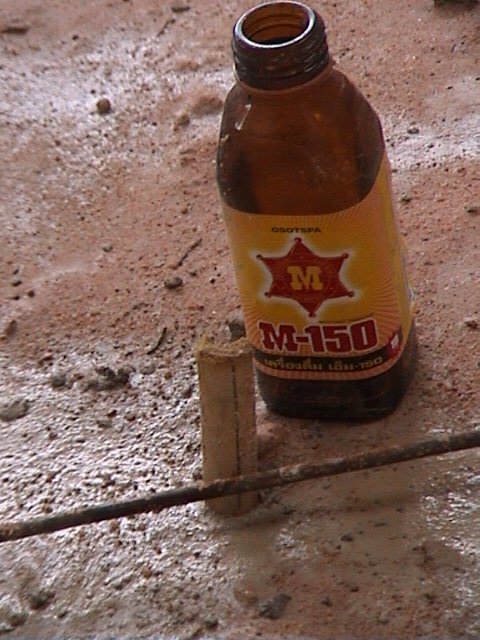

A stick is used to designate the height of the pour. Here we used a height of 7 centimeters for the pour (allowing 3 centimeter for the tile).

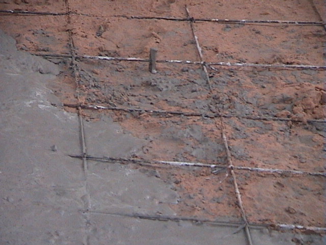

A square mesh pattern is created above the sand sub-flooring.

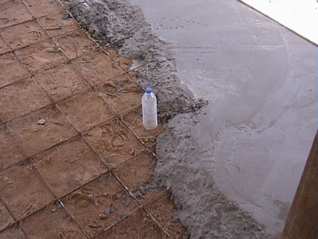

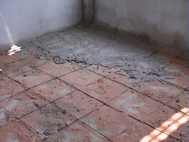

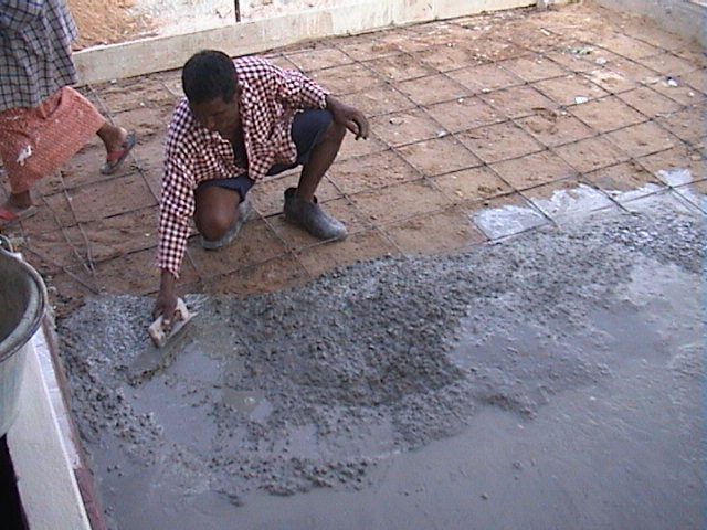

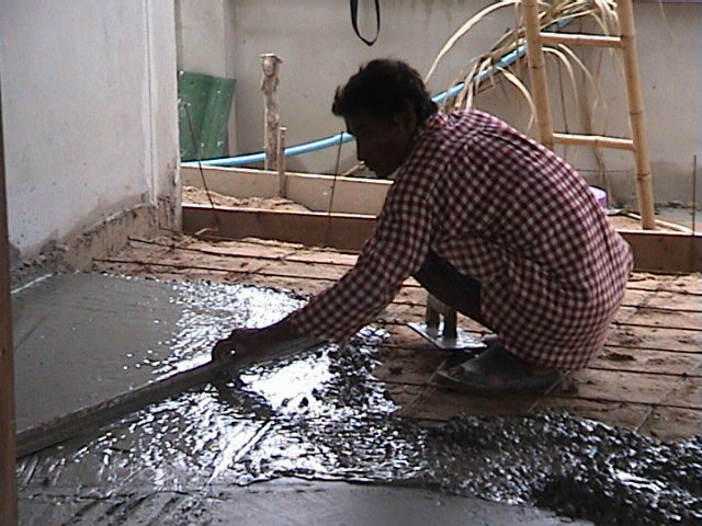

The pour in progress in the front bedroom.
Pour close up. (21-Apr-04)

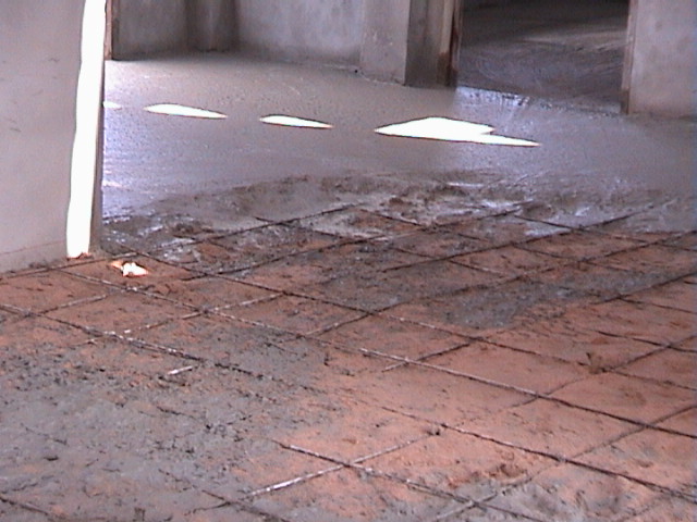

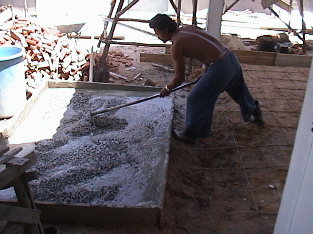

Pour in a room in progress.
A large pour nearly complete.

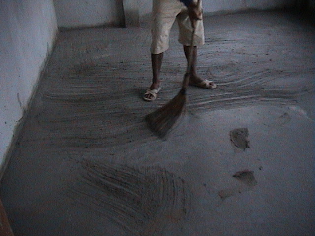

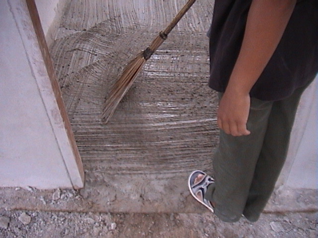

The still wet surface is 'roughed' with a broom in preparation for tiling. (20-Apr-04)
Roughed surface.

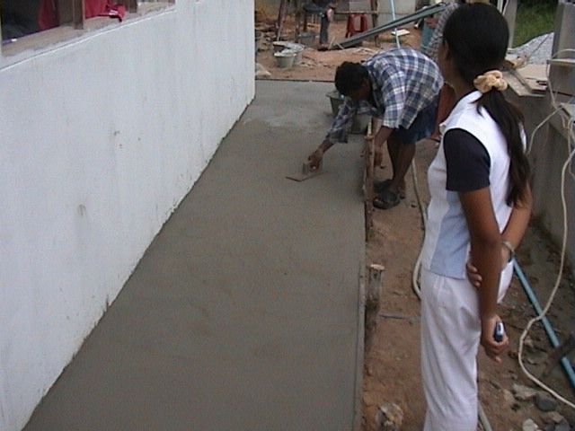

A smoothing tool is used to correctly level and slope a patio pour. (03-Jun-04)
Shaping the driveway. (27-Jun-04)
Outside surfaces that will not be tiled can be done is a semi-smooth, nonslippery, finish. (04-Jun-04)
