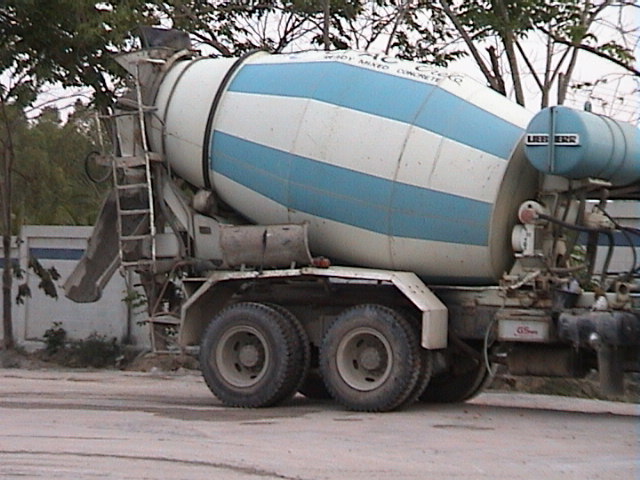

There are 3 grades of CPAC which can be ordered. The quality is comparable to hand mix. (03-Apr-04)

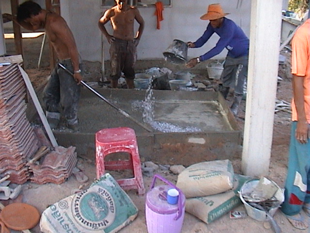

Cement mix is prepared depending on what is being done, but a normal mix would be 2 parts cement to 3 parts sand. Add in 4 parts stone to yield concrete. (20-Apr-04)

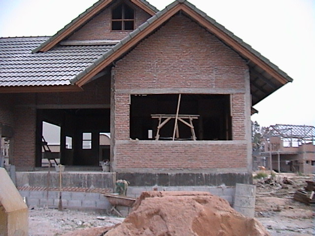

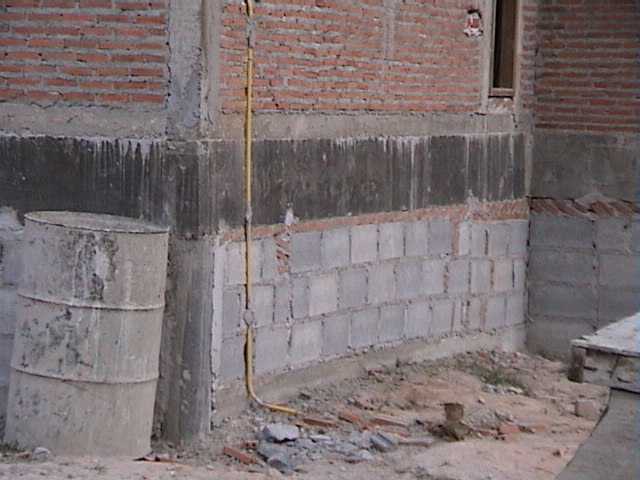

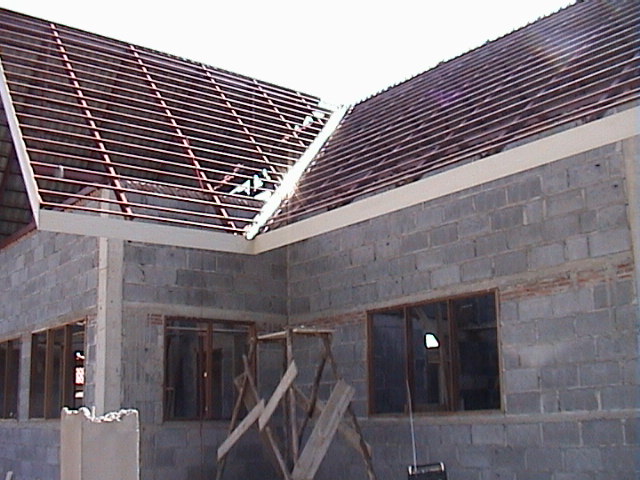

The basic materials for building houses are cement blocks, red bricks and superblocks. The least expensive material is the cement block, followed by the red brick and the the more expensive superblock. The cement block is produced locally is small factories and, although there is only one grade, sometimes the manufacturing process leaves the blocks not straight, which makes them harder to use. Other times the raw material mix is not correct and the produced blocks are brittle. As far as the brittle factor, you can check it by holding a block at shoulder height and dropping on a sandy surface. It should not break up. Red bricks are also a very popular material for building houses. And nowadays more and more houses are being built with the superblocks. The superblock a fairly light material with encapsulated air pockets which is designed as an insulator -- the idea being to keep the house cool. The downside to superblocks are the cost and also the fact that most construction workers normally don't have experience with them. Therefore a special team must be sought out at a higher than normal labor cost.

The cement block is the most common material used in house construction. The blocks are laid in rows, with cement used to fit each block in place. (28-Mar-04)

A house being constructed from small red bricks.
Close up of small red brick construction.

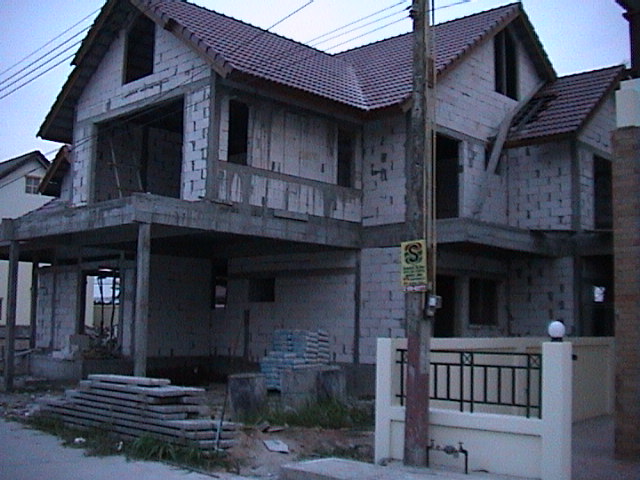

House being built with superblock.

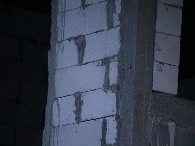

Close up of superblock construction.

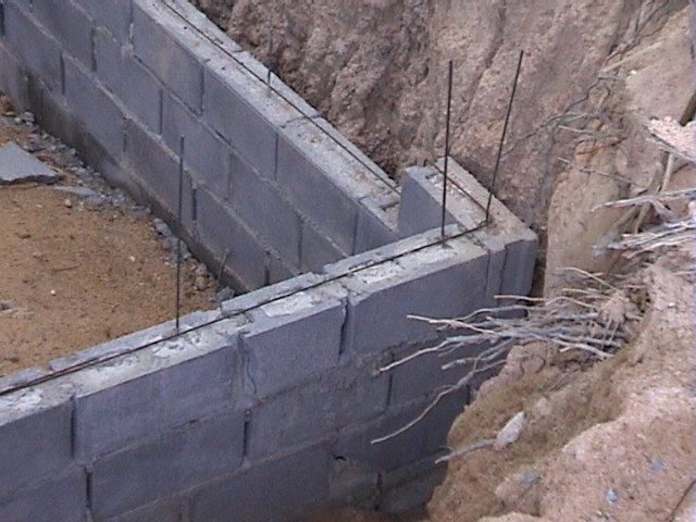

This shows and application using the heavy cement block. In this example it is being used to construct an underground water tank. (18-May-04)

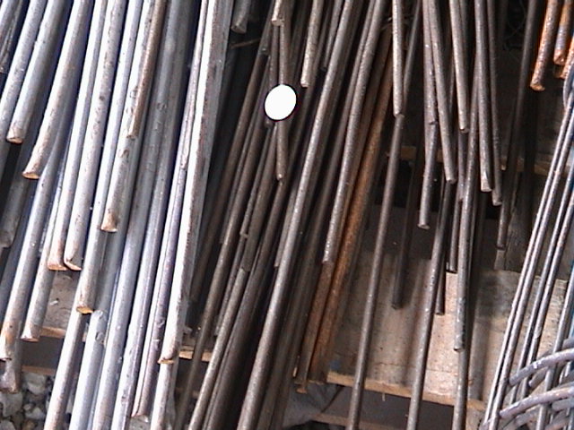

Metal rebar normally comes in long circular strands of 10 meters each. The unit of measure is the 'hun', each hun being 3 millimeters in diameter. The number of hun of the rebar determines its thickness, for example a metal rebar 4 hun would be 12 millimeters thick. Above 2 hun, there will be various designations of full, normal or light. These refer to the grade of the metal, with full being the best. The rebar is the backbone of house construction, it is what gives the finished product strength. It is used in the foundation columns, floor, walls and other areas. As an example, normally the rebar used in the foundation column should be 4 hun full or more. In flooring 2 or 3 hun strands will be used and tied together in a criss-cross pattern. For more information on the hun, visit the blog article that here --> hun: unit of measure for metal rebar .
This is metal rolls, which are sometimes used in floor construction to save money (but not recommended). A one Baht coin in the picture is used for scale. (03-May-04)
This shows 2 hun and 3 hun strands.
