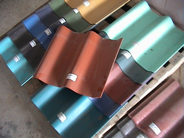

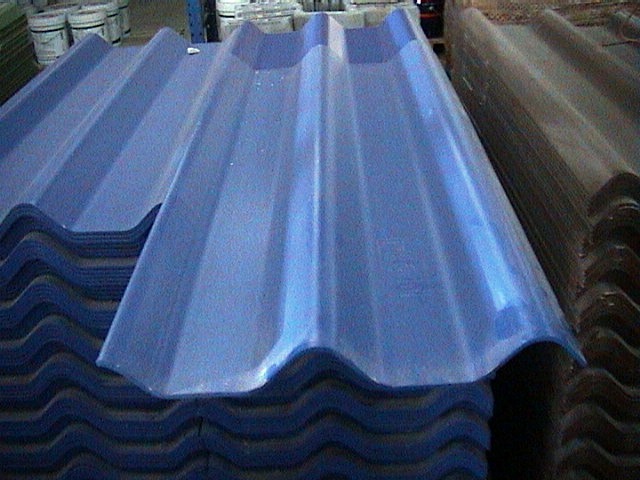

Synthetic roof sheeting of which there are a myriad of colors and qualities. Much cheaper overall than tile roofing. (21-Apr-04)
More sheet roofing examples. These pieces are about 60 centimeters long.

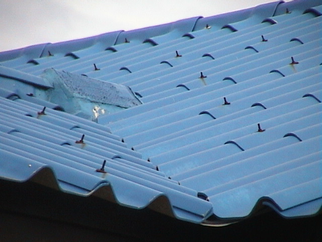

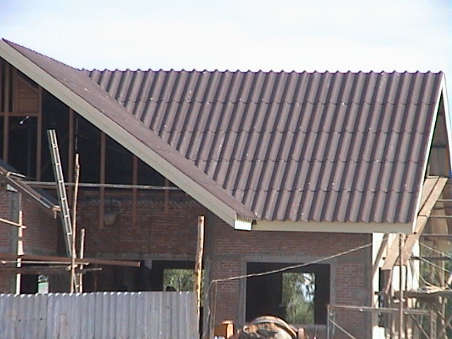

A house with a roof made of synthetic roof sheeting material. (12-May-04)
Close up of synthetic roof sheeting material on the roof.

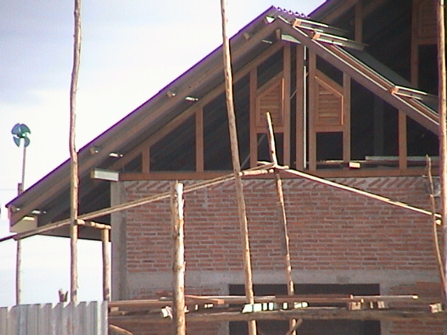

Another example of a house in progress with a synthetic roof. (20-Jul-04)
This close up of the same house shows the truss structure. The truss is made of mostly of wood.

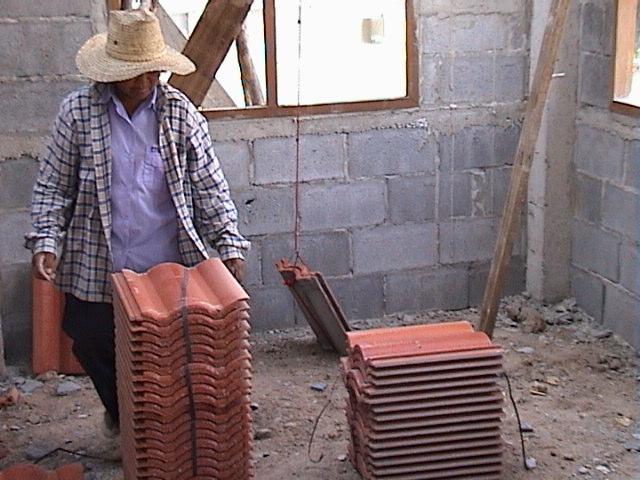

Closer view of the raw tiles. These tiles are being lifted up to the roof via a rope. Remember each tile weighs about 4 kilograms. (28-Mar-04)

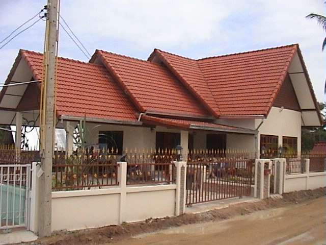

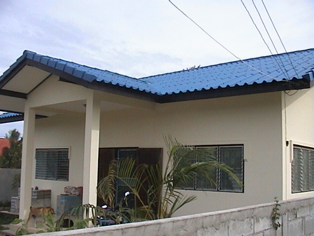

Tile roof example (cool thai house). This is the most common roofing material in use for houses built for foreigners. (03-May-04)
Tile roof example. (13-Aug-04)

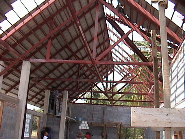

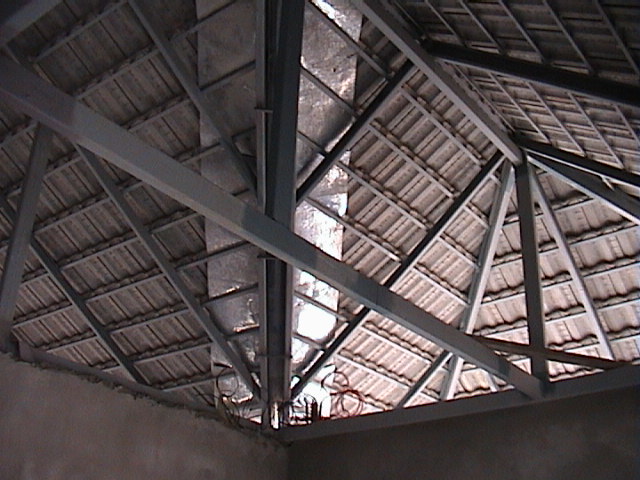

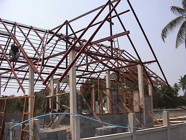

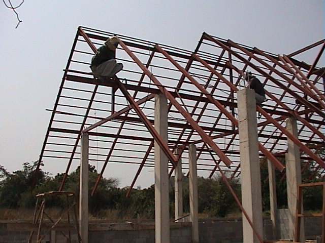

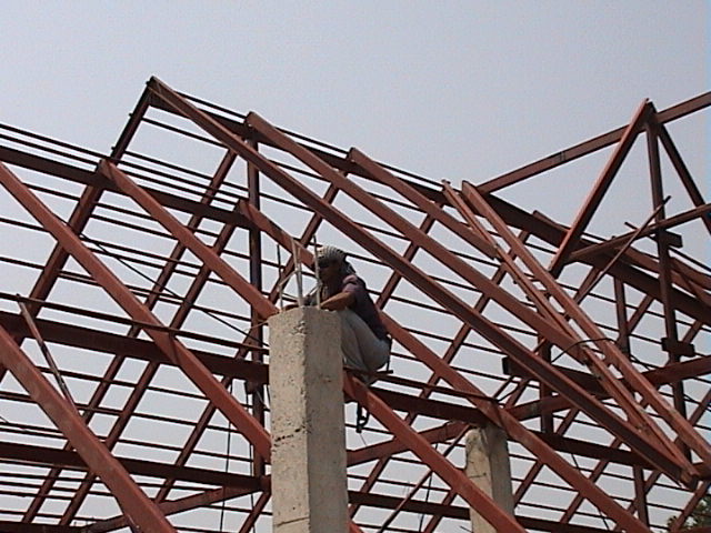

The roof structure is built using heavy gauge steel. The bigger pieces are 4 * 2 inches and 3.2 mm thick. The smaller pieces are 1 by 1inch and 1.6 mm thick. There are two designations, full and light, this is the full heavier gauge variety. (13-Mar-04)
The roof tile will lie on the 1 by 1, so they must be placed at proper intervals. Notice the cross beam supports which sits on top of the foundation posts.

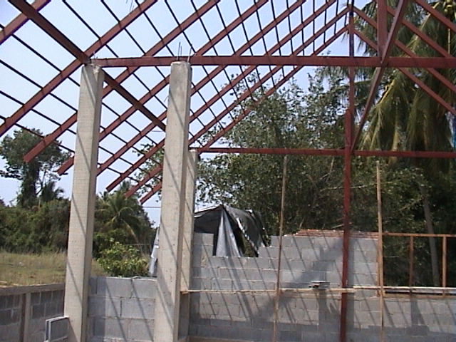

This shows most of the foundation columns as well as the partially finished roof truss. The roof height is 2.75 meters about the foundation pillars, the foundation pillars are 3.50 meters to the overall height is 6.25 meters.
Partially finished roof truss, rear side of house.

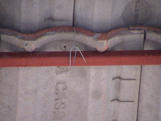

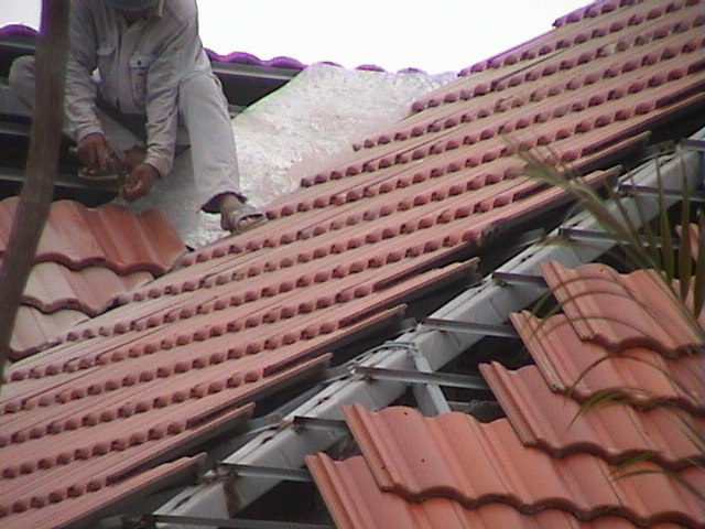

The roof tile is wired on to hold it in place. Notice the tile sits in place on the 1 * 1 metal cross beam. (22-Mar-04)

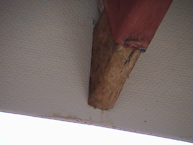

A piece of wood is extended from the roof metal to allow the facia board to be attached.

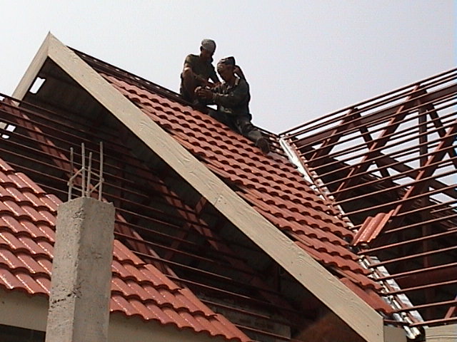

The nearly complete roof truss. The supporting walls must be complete prior to starting to lay tiles on the truss, otherwise the truss metal will bend.

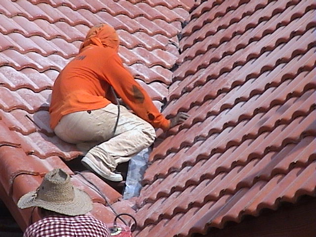

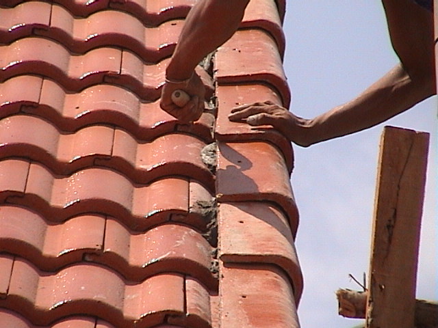

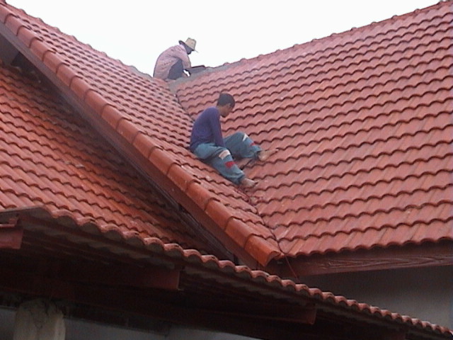

Cement work on the roof tiles. (26-Apr-04)
Front valley being completed. (30-Apr-04)

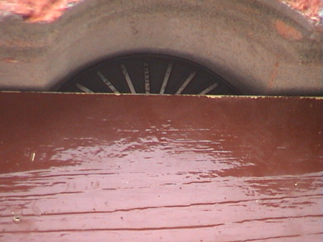

Plastic inserts like these come in easy to install strips, each piece covering 3 sections (like the one shown). The are used to prevent birds and rodents from entering the attic area. (09-May-04)
