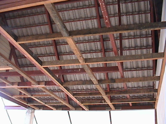

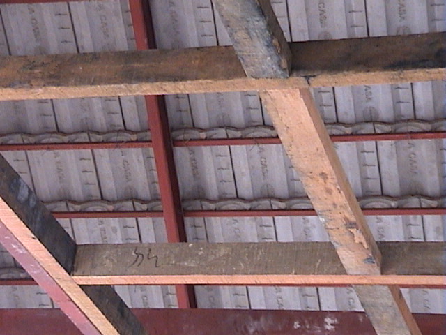

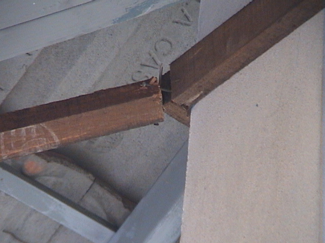

The main thing to watch for with grc sheeting is that the wood foundation is made of the proper wood. The wood should be 1 1/2" by 3". Using coconut wood, which is commonly done to squeeze a cent, is not recommended. It will degrade quickly if it comes in contact with moisture and is not very durable. The coconut wood which is often used (as shown below) is about 1/2 the size of the standard 1 1/2" by 3" wood.
Make Sure Not to use Wood Like This
Here are a couple of shots of coconut wood framing. If your buying a house you might want to get a look under some grc sheeting to see if this type of wood was used.
An example of a house using coconut wood as support for outside grc sheeting. This wood degrades quickly and will lead to problems in a few years time. (25-Jul-04)
Close-up of inadequate coconut wood used to support grc sheeting. (25-Jul-04)

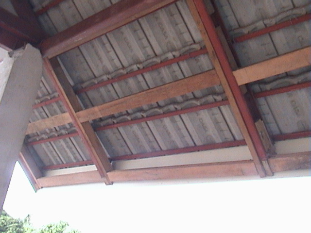

This example shows how grc sheeting is applied to the underside of the eves and as the ceiling over the carport.

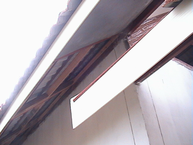

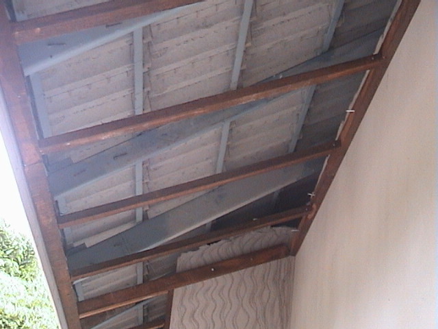

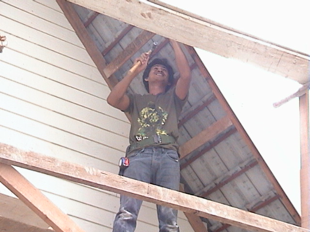

Building the wood framework. (24-Apr-04)
Wood framework. (02-May-04)

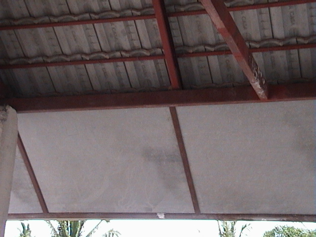

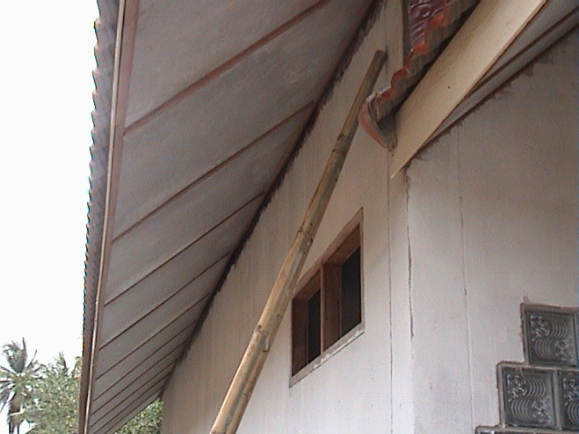

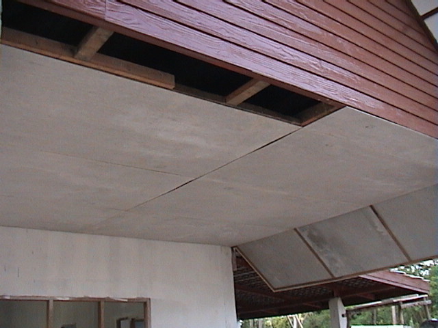

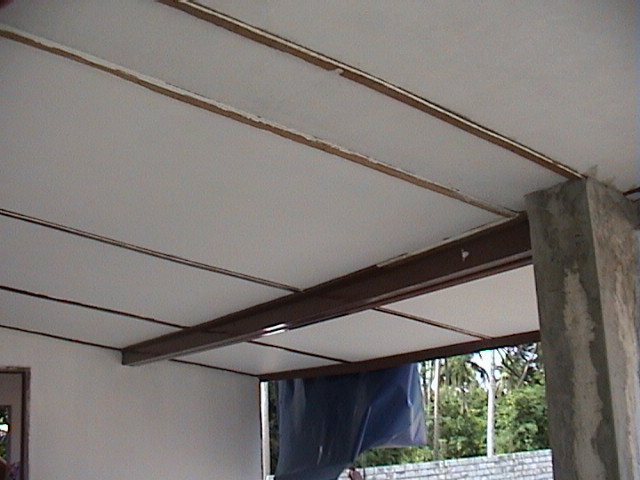

The grc sheeting is applied in sections like this. A decorative wood strip is applied as a separator on top of the grc sheeting. (03-May-04)
A partially enclosed section on the back part of the house.
A completed but unpainted section on the back part of the house. (05-May-04)

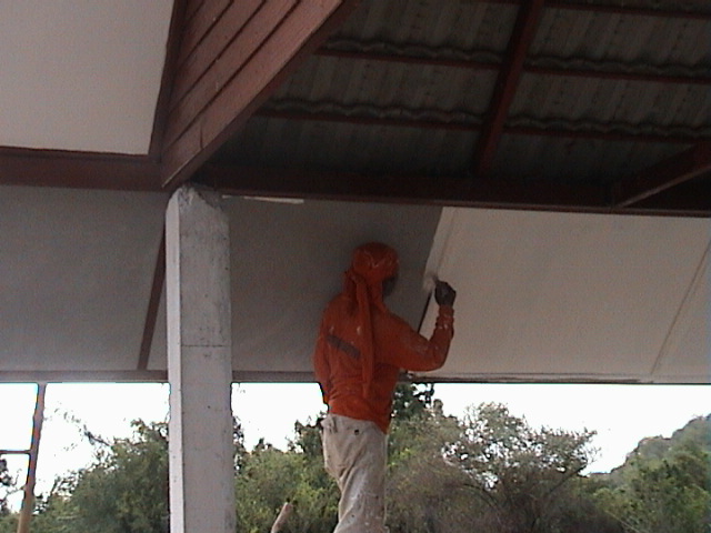

Applying a primer coat of paint. (08-May-04)
The wood framework above the parking area. (11-May-04)
A close up of the wood structure.

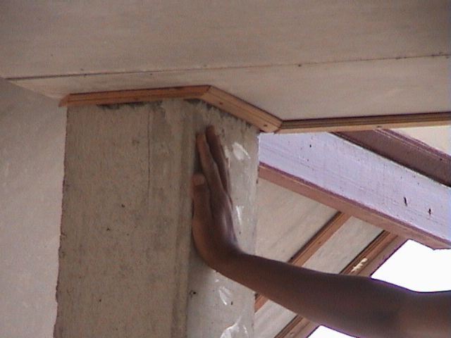

Decorative wood trim is applied around the foundation posts. (12-May-04)

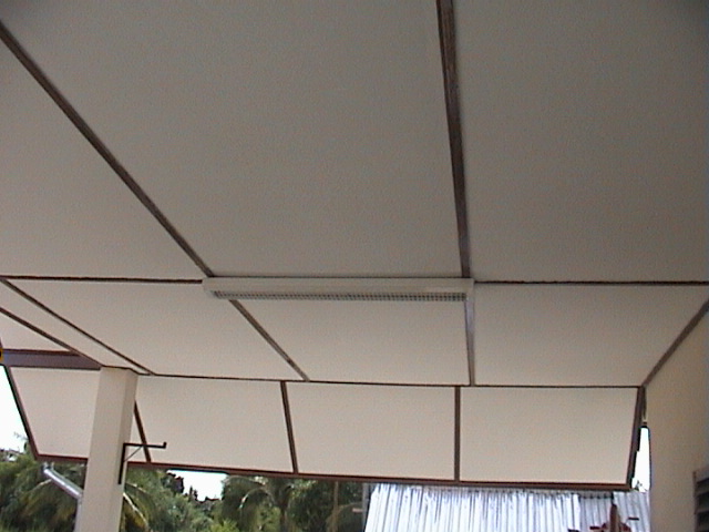

A completed and painted section in the rear of the house. (08-Jul-04)

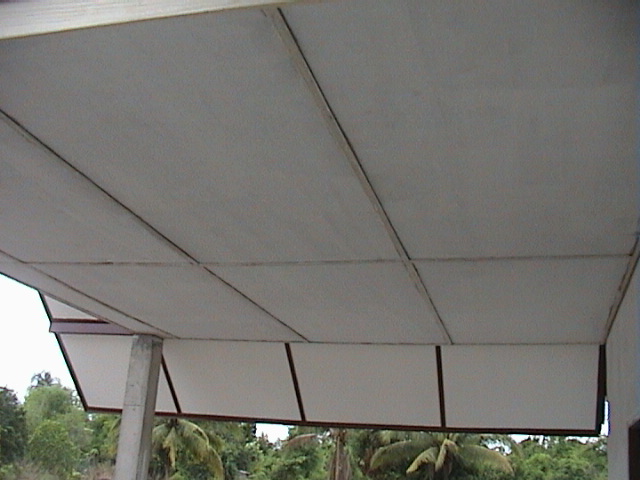

The completed section over the carport. (28-Aug-04)
