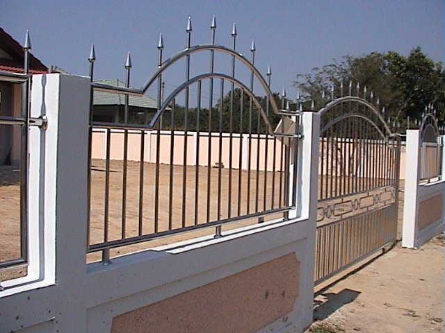

As far as cost and style, the most basic decision is whether to go stainless or not. Stainless is better quality and will not rust. Except for the detail highlights stainless isn't painted, so there is no paint to wear off. The downside is that stainless is very expensive, probably at least twice the cost of using regular metal. Not only that, on less than large luxury houses I don't think it looks that good, being that it is kind of pretentious and gaudy looking. Besides, if regular metal is properly primed and painted, rust is not that much of a problem.

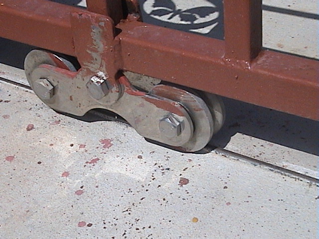

The most critical part of the gate, in my estimation, is the wheels. I've been in rental houses with the cheap 1" wheels, and they are produced to last about 6 months. After that the bearings start to go, and it is a painful ordeal to open the gate. If you going to the trouble to put it together, use good wheels. The really good wheels are made from stainless and are difficult to find in and around Pattaya. I bought the ones in this example on Theppasit road, and paid a really inflated rip-off price. Then later I saw good quality 3" stainless wheels at Homepro for under 400 Baht each, less than 1/2 what I paid.

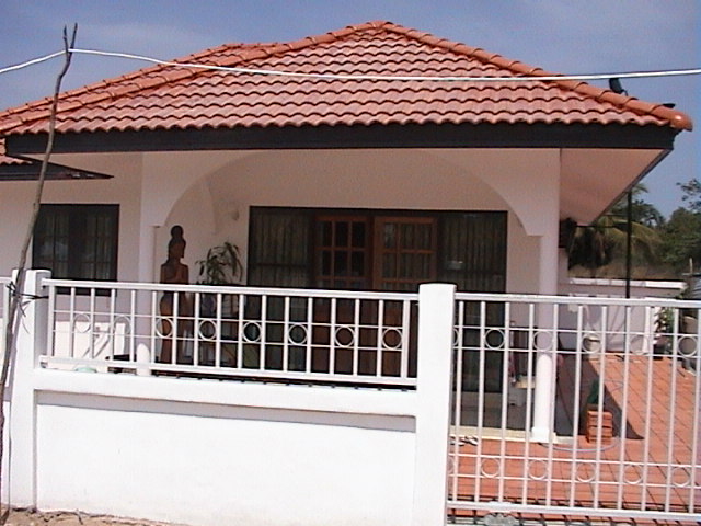

Very simple gate and metals design. (19-Apr-04)
Simple design with security metals on top. (15-Aug-04)

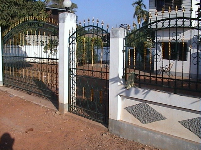

A popular design style with rounded tops and security arrows on top. (31-Dec-03)
Another example. (01-Jan-04)

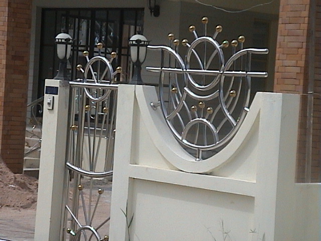

A stainless security section and gate to the right. (01-Jan-04)
Stainless gate. (24-Jun-04)
Stainless security section.

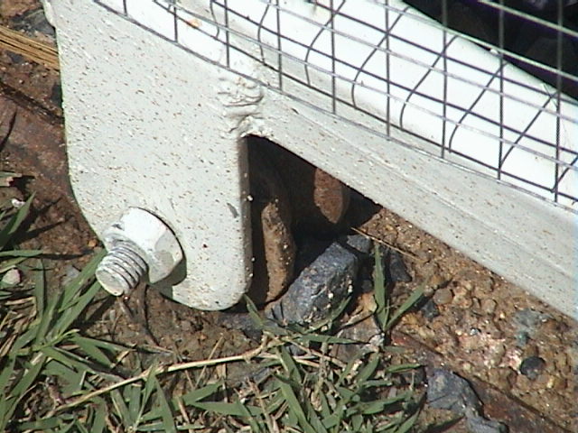

The gate wheels are very important. There are two sets of heavy duty 3" stainless steel wheels needed to support a sliding driveway gate. (27-Aug-04)
Here is a one inch cast metal wheel. It just doesn't pay to save on gate wheels as cheap ones like this will wear out very quickly.

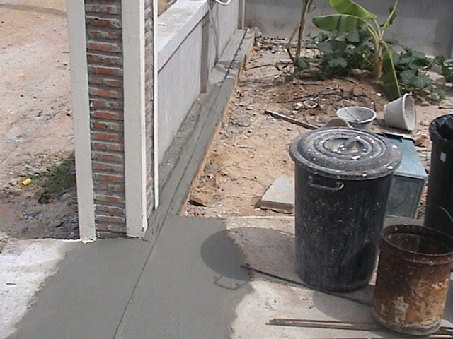

A track formed from a two sided piece of metal laid in the ground with the ridge side up. It is cemented in place. (15-Jul-04)

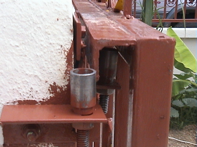

Roller mechanism for the gate. There is one metal roller on the outside and one on the inside of the upside down 'U' piece of metal. Metal rollers, even though subject to rust, are better than the plastic ones which wear out quickly. (29-Jul-04)

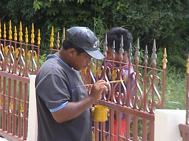

As far as painting, normally there is a primer coat used and then after that the regular color on top. For detail work gold leaf paint is often used. A yellow primer is first applied and then the gold on top of that. There is a good quality paint imported (from Italy) which is widely used. (31-Jul-04)
