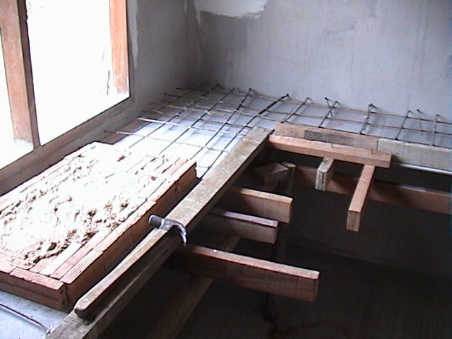

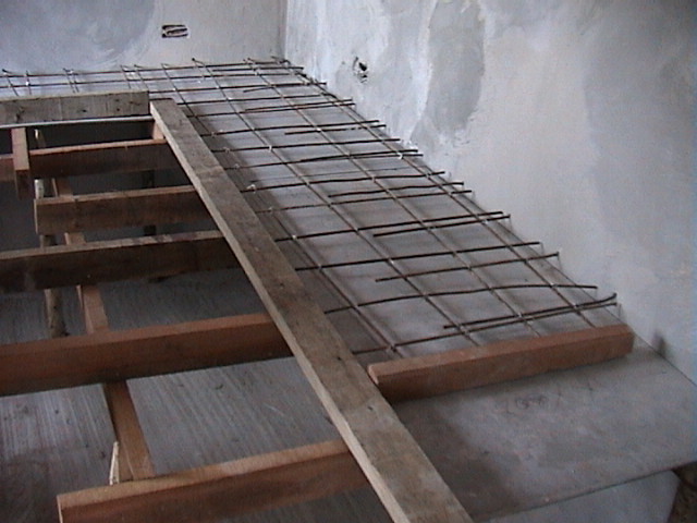

The metal for the kitchen counter is secured on top of some grc sheets and drilled into the wall prior to pouring cement. (26-Apr-04)

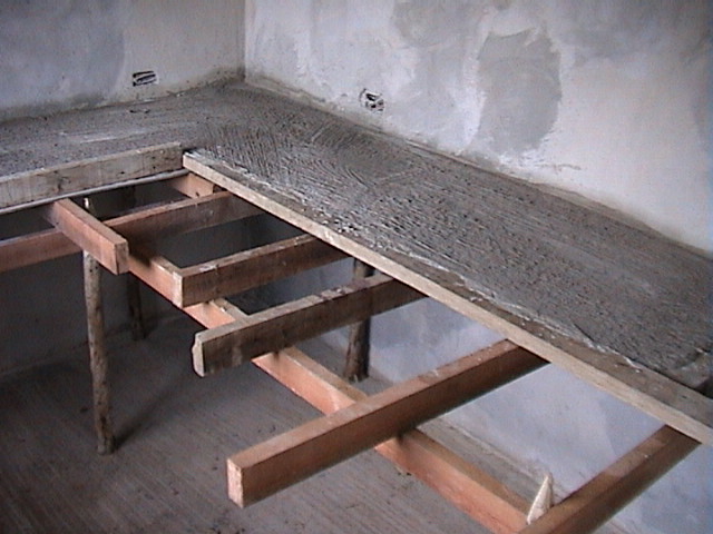

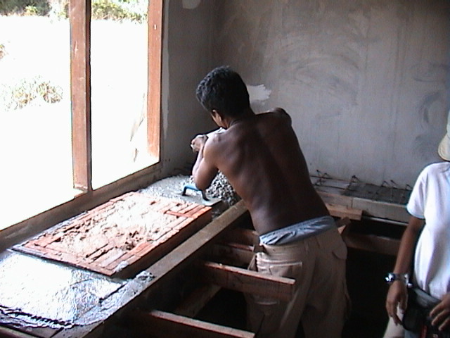

Pouring cement to form the counter.
The counter after the cement pour. (27-Apr-04)

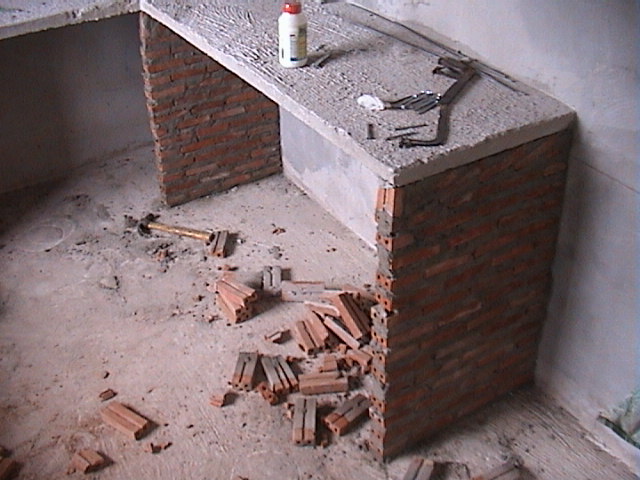

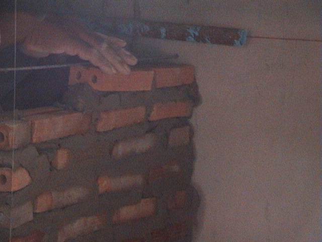

The counter will be supported by red brick columns. (13-May-04)
Partially finished counter with supporting brick columns.
Metal rebar (2 hun) is used in forming the brick column supports to add strength. A hole is drilled in the wall so the metal can be inserted.

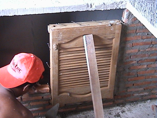

Nails are used on the outside of the cabinet to anchor to the surrounding wall.

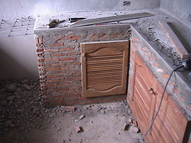

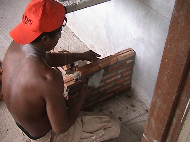

A counter section after the red brick enclosure is complete. (14-May-04)

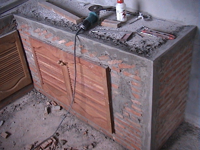

Each cabinet section has a wood door.

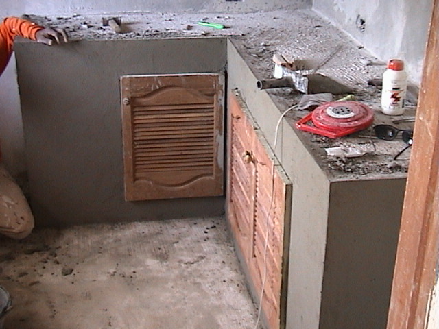

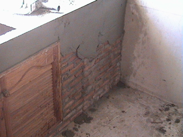

Here stucco has been affixed.
This shows a relatively think layer of stucco is applied.

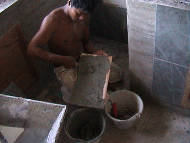

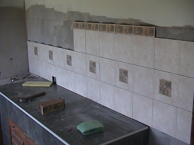

This shows the rough finish on the stucco and the tiles being applied. Cement unmixed with sand is used as the affixing agent. (15-May-04)

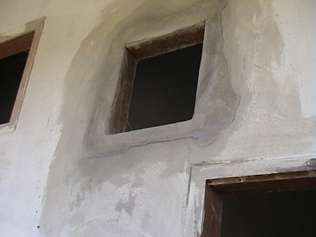

This shows the opening formed for the exhaust fan. The opening is made from a wood frame cemented in place in the wall. The fan fits in place and can be slid out for cleaning. (18-May-04)
The cement surface of the cabinets is rough finished to allow the tiles to affix easily.

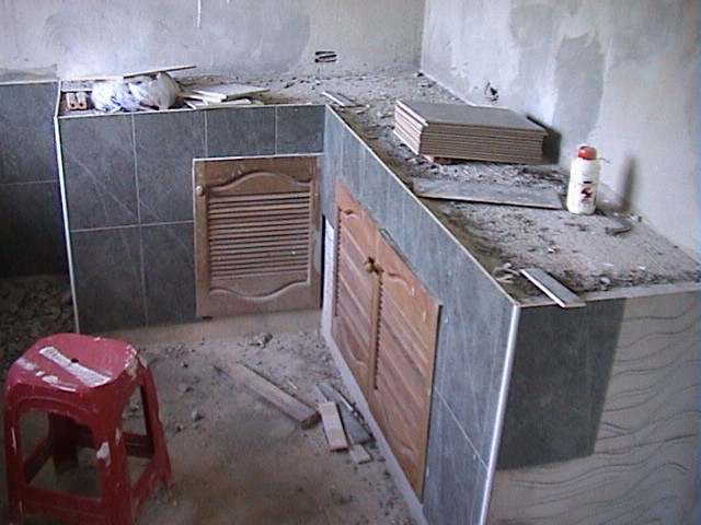

Partial wall tile completed.

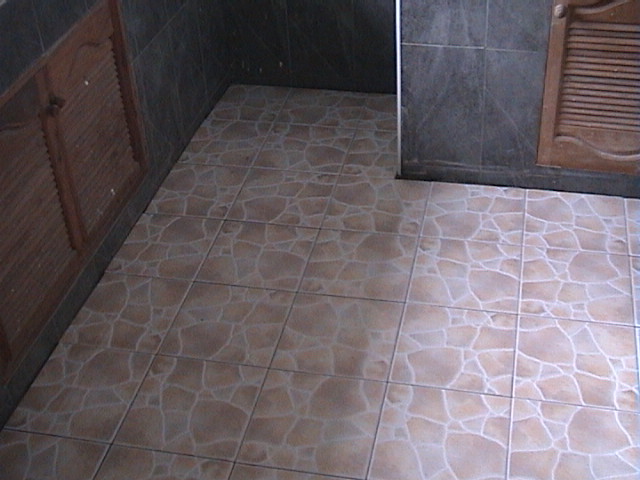

Floor tiles. (26-May-04)

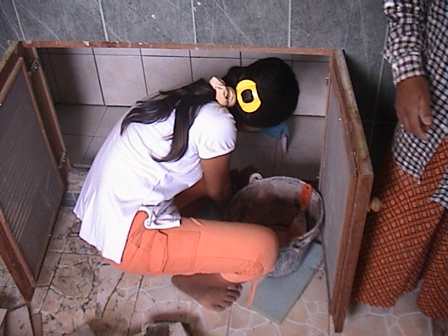

Affixing grout to the tiles on the inside of the cabinets. (19-Jun-04)

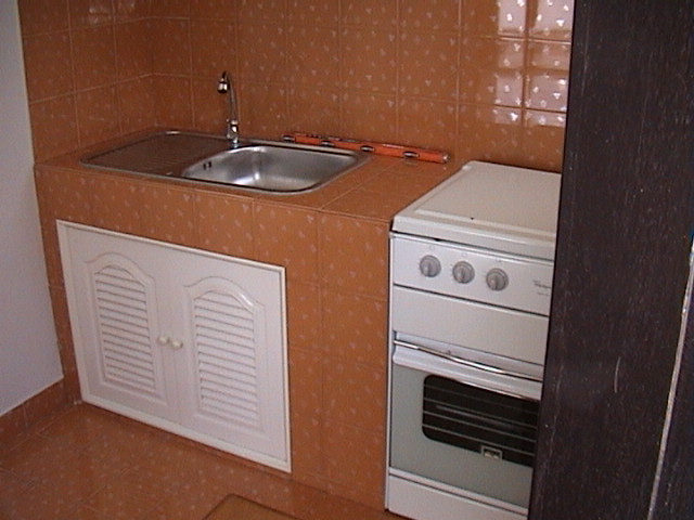

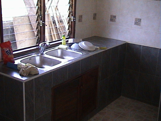

Finished cabinet section with stainless sink installed. (06-Jul-04)

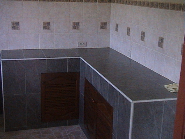

Finished cabinet section. The cabinet doors have been varnished with three coats of good quality wood varnish.

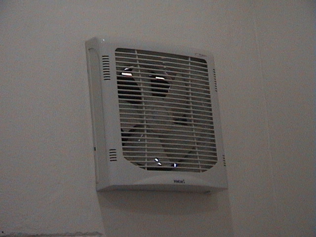

The wall exhaust fan looks like this. It is wired to a separate switch on the right hand side of the sink. (24-Aug-04)
