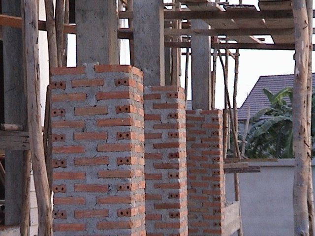

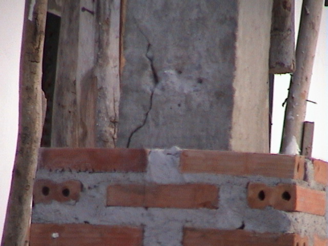

The foundation columns should measure about 17 centimeters square. A common practice nowadays is to use a real thin foundation post with brick surrounding it. These are not nearly as strong as the thicker all concrete ones. (21-Apr-04)
Here is a close up showing a stress fracture on the thin concrete foundation column.

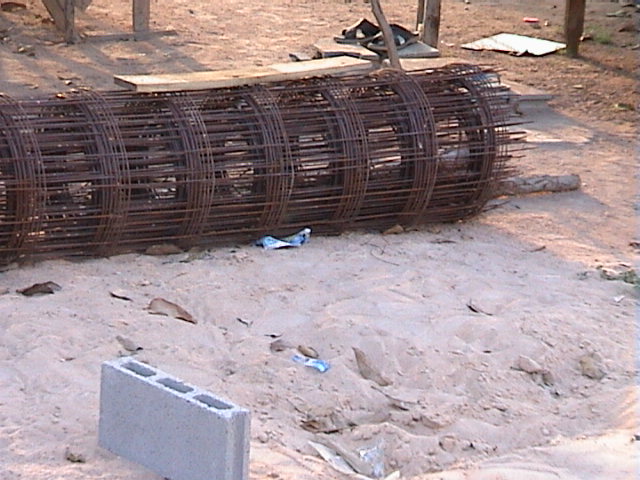

Prefabricated rolls of metal, like the one shown here, are often used instead of hand tied metal in laying a floor. This leads to lower strength of the floor. (21-Apr-04)

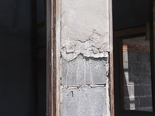

Here is a wall section in which the support post was poured before the blocks were laid. You can tell by looking at the seam between the post and the adjoining cement blocks. This leads to a wall of less strength. Another thing which occurs frequently is that metal cross supports are not used to attach the post to the adjacent blocks. (14-Jul-04)

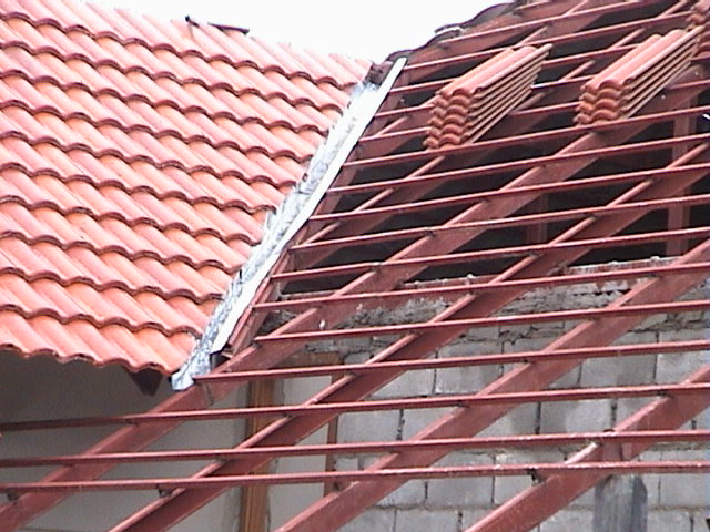

An example of inadequate roof flashing material of inadequate width being installed in the roof valley. The roof flashing installed in the valley should have a width of almost a meter. (21-May-04)

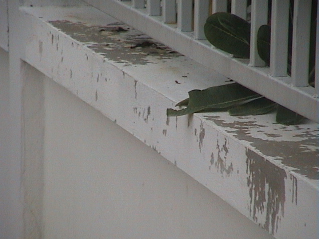

This was just painted. No paint at all is better than low quality paint that comes off when put in contact with water. (25-Jul-04)

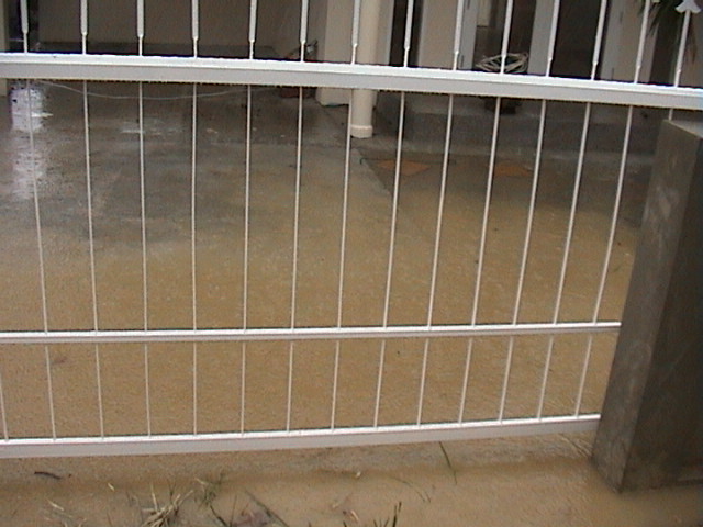

This shows the worst offense: inadequate fill dirt at the start of construction means the house will flood later. It is a problem which is very difficult to correct. (18-Jun-04)

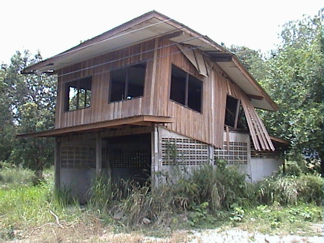

What happens if you cut one too many corners! (09-Apr-04)
