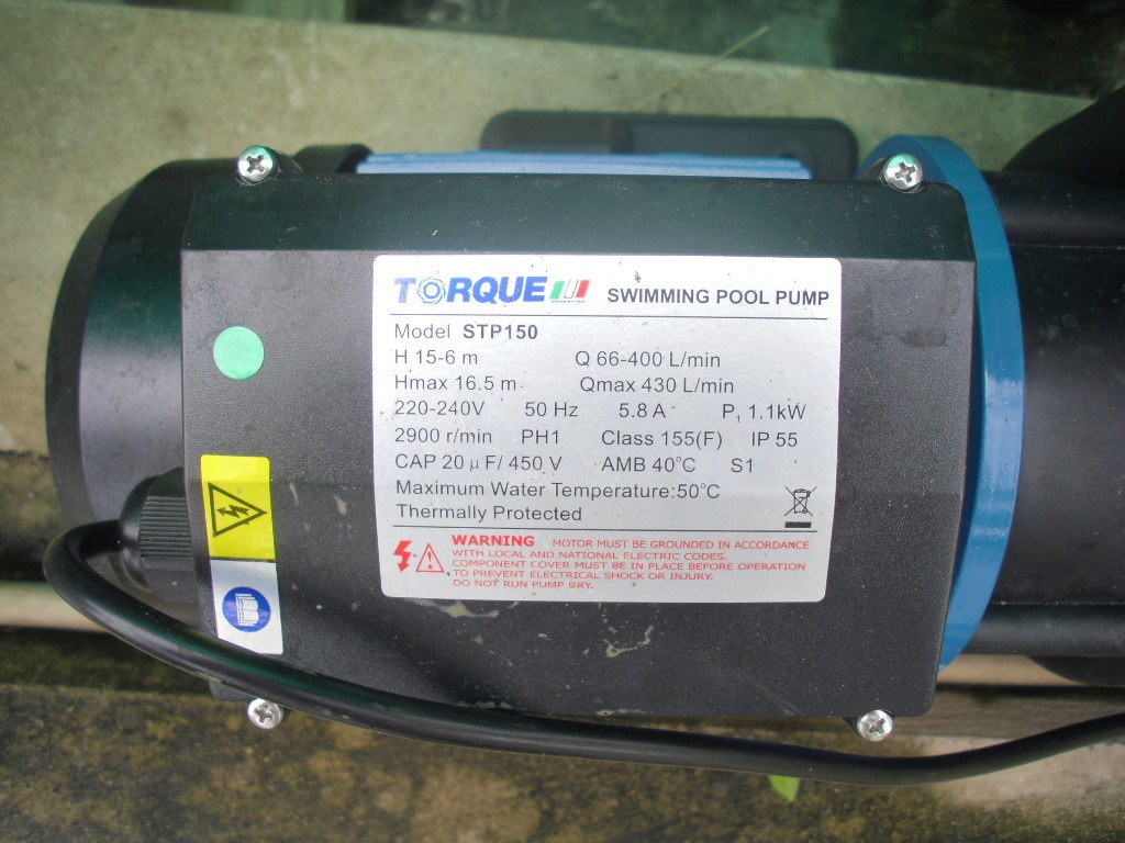

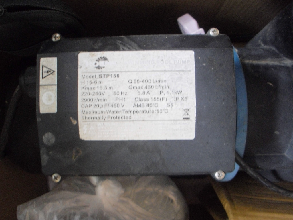

Postby Klondyke » Sun Sep 17, 2017 10:02 am
Dimensioning diagrams for pumps can surely help for a pump selection. However, there are always many factors correcting the calculation we hardly be able to determinate. Hence, we will precisely calculate with inaccurate figures.
The correcting factors are the lengths of the pipes, their dimensions, number of elbows, number of valves. Then the resistance of the sand filter (its size, sand dimension). Then the location of the pump, its height against the pool water level.
So, I doubt that such pump dimensioning will bring something, rather a headache. The purchase will be decided as what is available in the near area and how much I want to spend. If I buy a stronger pump, I can recirculate less hours daily, with weaker pump more hours. So, at the end of the day the same results for me, in m3/day recirculated and in kWh/day spent either.
In my thread about affordable pool I have mentioned the pump I bought some 7 years ago at a pump shop (not pool specialist for 7,500 Baht. That pump was years ago flooded, then re-winded, still working. A similar pump I saw at GH, however, they do not sell it separately, together with a small (useless) filter for 11,500. Still there, they have not changed their sortiment over years, don't sell separately.
Just last week I was passing by the pump shop who sold me my pump, asking what is available? Yes, the same pump, just 1,000 B more (8,500) with a new name, exactly the same shape, label and outlets (2"). I bought it to have a spare, I am hearing my old pump much more than before, the bearings will need to be exchanged. Within 5 min. to have it exchanged.
Old pump (ROWAN):
New pump (TORQUE):
