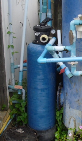

Well, as I have showed in my thread of affordable pool, from GH I have their swimming pool filter. And after I had run with it for few years without any problem, some time later I had needed to get one more filter for my "ingenious" water treatment, described in viewtopic.php?f=14&t=4611 . So I bought another same piece in GH (7,500 Baht) - since well-proven - and installed it as the first filter after sedimentation tank, suitable for regular backwashing (by the same water 3m higher after sedimentation).
The filters are sold empty. The sand I am buying at village people washing river sand, selling it in bags sorted by its size, started from some 0.7mm. There is not much chance at such filter that something goes wrong once the sand is carefully filled in, not to break the intake pipes at the bottom. In Internet pool blogs - I mentioned in other thread - I had often read about problems when sand has been found at pool bottom, caused by a wrong function of filter - bought not in GH.
Beside PVC piping and fitting I bought in GH a telescopic pipe for bottom sucking, brush and the sucking head. Also my first 1 - 2 flexible hoses for sucking, that however had not lasted long. Having now one from my pump supplier (not a pool specialist), much more expensive, however, no problem over last 5 years, even when exposed to sunshine, always stashed in OF channel.
