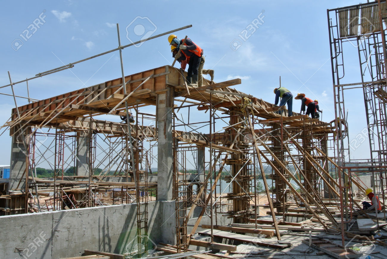

"Sau" - in Thai a pylon, column. In the country of the "golden teak" the house was always started by erecting massive columns, mostly by a fat teak. The fatter "sau", the better image for the owner in the village.
When the availability of (a legal) teak had been substantially reduced some 30 - 40 years ago (and its affordability as well) another material has been quickly found - the concrete. And the concrete in Thailand has been quite affordable, cement production has been developed very fast, all the input materials are easily available.
So, the traditional style of construction has been further easily continued, first the "saus" (now by concrete), then hurry up with the roof to get a good shade, the walls come later, they are not so important. They had been always also by a wood, no problem with insulation, the wood does not accumulate the heat anyway.
However, the new modern materials create certain constrains for the construction: the erection of the "saus" does not go so fast as with the teak, neither the horizontal beams. It needs a lot of wood for a formwork and its support and steel bars. And moreover, the material for the walls is really the least suitable for the local climate. The walls are mostly made by single blocks or bricks 7 cm thick, with the cement rendering the wall width comes to some 10 cm. A material that easily accumulates the heat from outside during the day and later in turn, gives the heat away inside the house up to late night when the outside air is already quite pleasantly cool.
